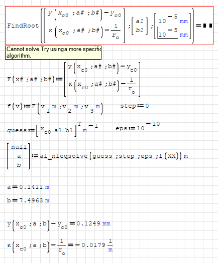

#1 Опубликовано: 07.10.2023 16:31:52
Valery Ochkov
Valery Ochkov
CP-Cyrcle.sm (24,37 КиБ) скачан 1415 раз(а).
#2 Опубликовано: 08.10.2023 08:58:36
roots supports a single argument
Valery Ochkov 08.10.2023 09:05:00
#3 Опубликовано: 08.10.2023 09:04:57
Valery Ochkov
Valery Ochkov
#4 Опубликовано: 08.10.2023 13:51:08
You don't have to eliminate units.
There are tricks to use them in solvers.
This is the best I could get.
Maybe a pro user can help you better.
roots() supports multiple argument btw.
Your equations has derivative.
Possibly reason of error by conventional solvers.
roots(), FindRoot(), solve() mostly doesn't like it.
CP-Cyrcle_solved.sm (32,37 КиБ) скачан 1436 раз(а).

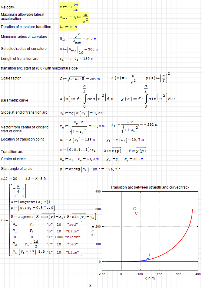

#5 Опубликовано: 09.10.2023 05:44:58
This is a version without solving equations. The curvature is known as a function of the path length.
02 Ubergangsbogen.sm (80,24 КиБ) скачан 1490 раз(а).
Valery Ochkov 09.10.2023 05:52:00, Oscar Campo 09.10.2023 07:39:00
