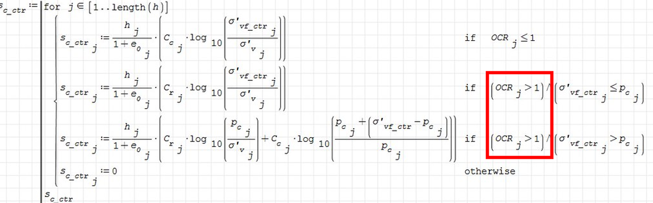

#9 Опубликовано: 21.11.2023 20:59:56
There is room for improvements in the conditions management.
Since the first case catches all the conditions where OCR[j] <= 1, the 2nd and third "(OCR[j] > 1) AND" checks are redundant.
Also, since Sigma'vf_ctr[j] <= pc[j] case is captured in the second condition, the third case can be written in the otherwise placeholder.

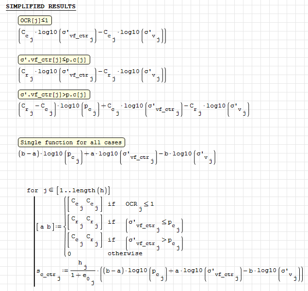

#11 Опубликовано: 21.11.2023 22:22:20
If I didn't made a mistake, this is most simplified I could get.
Here is the file contains logarithmic simplification steps.
cases_simplified.sm (35,71 КиБ) скачан 1468 раз(а).
