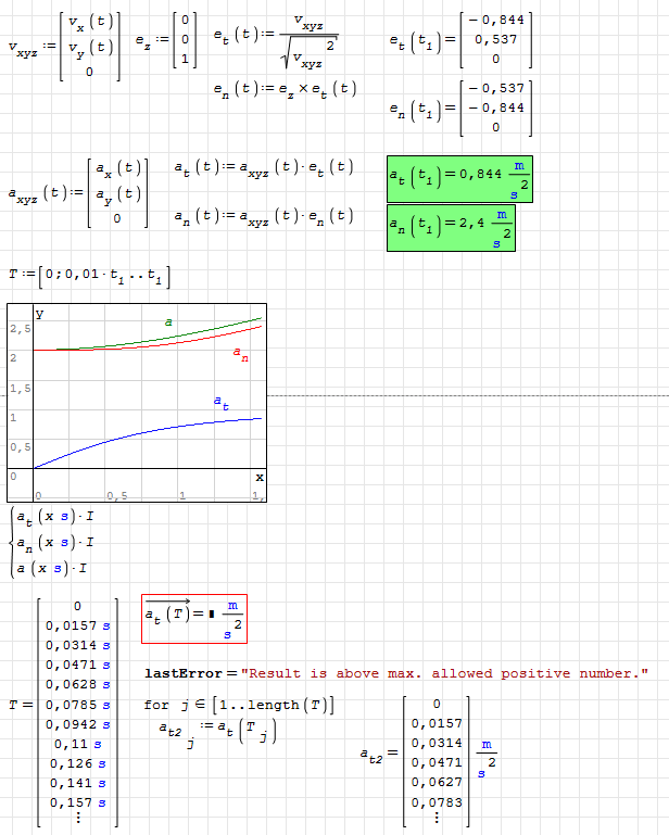

Why does the vectorize operation fail while it seems to be safe to use an explicit loop?
6-2-Bug.sm (27,78 КиБ) скачан 1685 раз(а).

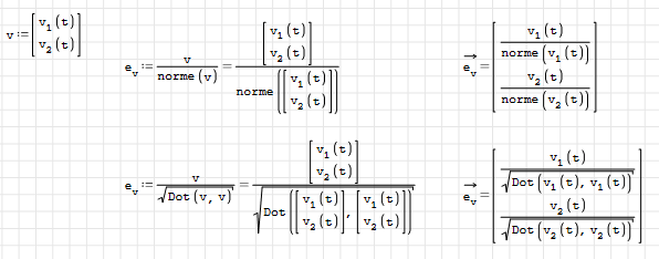

Hi Martin. Because you have just only one function which can't be vectorized: the norme or dot product of vectors.
sergio 22.11.2023 04:05:00, Martin Kraska 22.11.2023 04:36:00, ioan92 22.11.2023 04:58:00

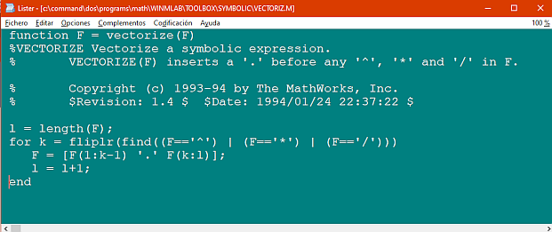

Pretty old matlab version, from its symbolic toolbox

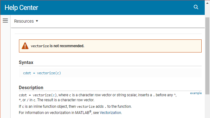

The help page from the newest version
So, it looks like they have some issues with automatic vectorization.

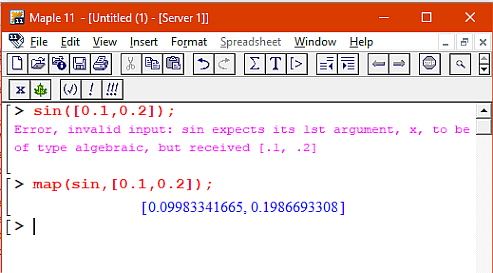

With maple it is very uncomfortable, you need to use map even for simple cases

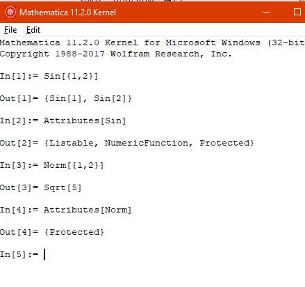

Wolfram's solution is very practical: Function with attribute 'Listable' expands over lists
But for make a table you actually need a loop or the Mathematica's Map function.
