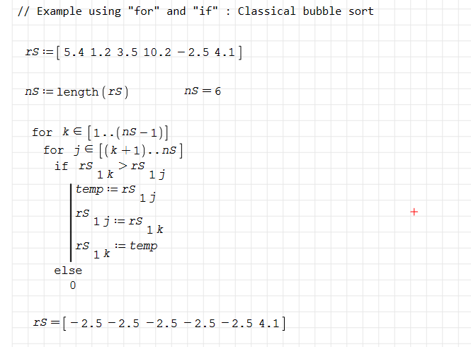

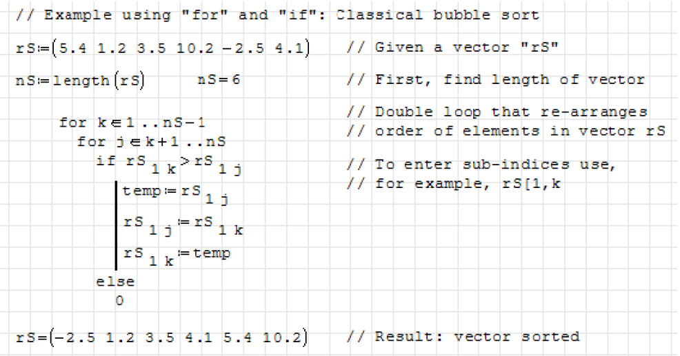

I am studying with Introduction to the use of SMath Studio Prepared by Gilberto E. Urroz, May 2010.
but i try to this,
result is
rS=mat(-2.5,-2.5,-2.5,-2.5,-2.5,4.1,1,6)
what is problem?

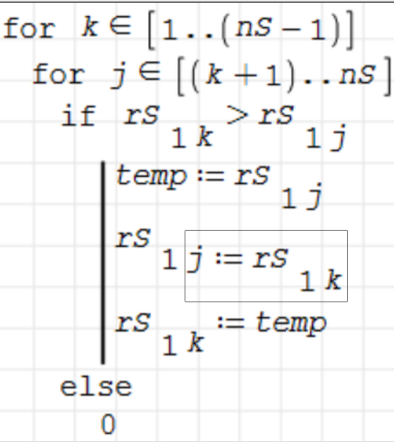

Hi. You have j := rS[k,1]
