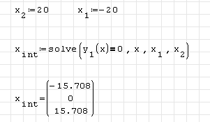

The solve function gives a real number if there is only one solution, but gives a matrix if there are multiply solutions. As in the screen shot below:
or
This is fine until you need to use a looping worksheet that needs to do matrix operations on the result. Is there an easy way to test whether a variable contains a matrix or a real number? This would allow for conditional statements that would perform one series of operations if the variable contains a real number but another series if the variable contains a matrix.

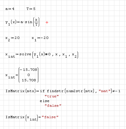

Why does this not work?
Will Massie Mechanical Engineer Oregon, USA
#11 Опубликовано: 11.08.2010 15:28:54
Hello Will,
I can reproduce this as well.
It seems that whatever the argument of IsMatrix was, it returns "false". A bug maybe or something else?

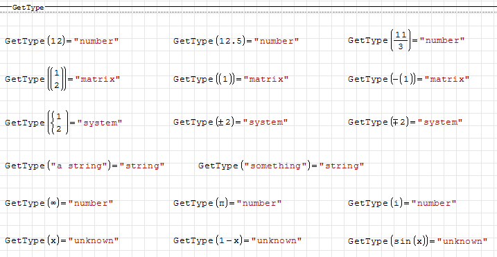

If you download the plugin Custom Functions, you can use GetType()
2016-03-23 19_57_02-SMath Studio Desktop - [CustomFunctions_examples.sm_].png

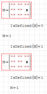

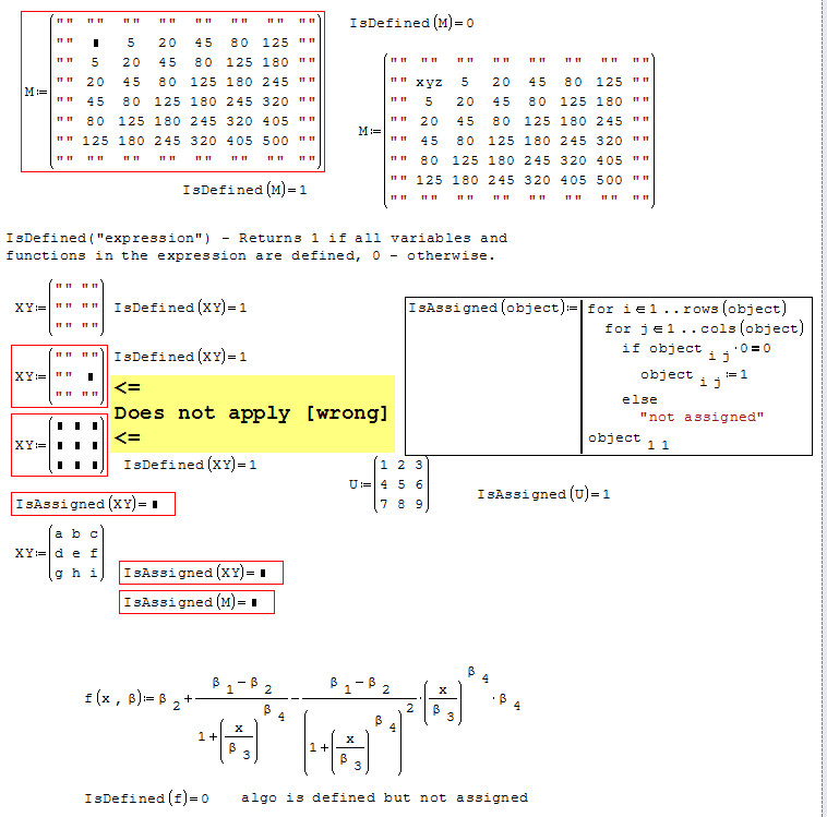

The Smath "IsDefined" works for matrices > the default .
Does not work for vector . "IsAssigned(object) would be
more inductive. Don't know how to return the last message.

Jean,
when an error is thrown the result is not stored -> this means that in SMath Studio is not possible to define a matrix with empty placeholders -> your IsAssigned will never works under these assumptions...
Hence, also IsDefined() works correctly because the first assignment of XY is not overwritten nor deleted, hence it is still in memory (XY is defined in the worksheet memory).
BTW, you shouldn't use "object" as target of the function [el(object,i,j):whatever], you have to use a brand new matrix defined inside the function (because the pass-by-reference, if you use an argument as target of some calculation you are modifying it)

Thanks Davide,
I guessed right you would have wise guidance.
Mathcad "ifNaN", "ifIsScalar" OK ... other "if" ???
