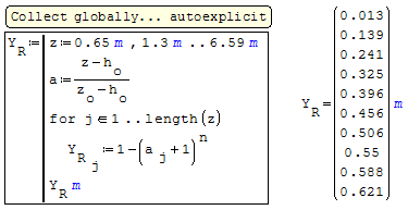

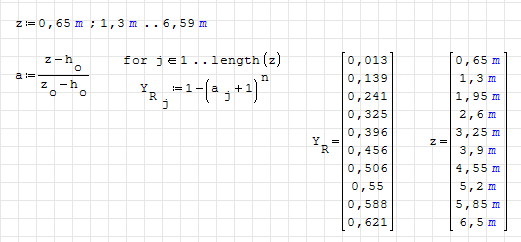

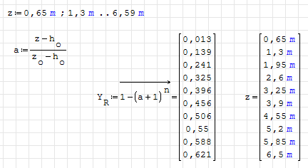

#2 Опубликовано: 24.08.2016 12:47:41
Hello Berk,
To accomplish you task you have to loop through the values of the input vector; to do this you can use the function vectorize(...) or a loop (for(...), while(...));
vectorize:
loop:

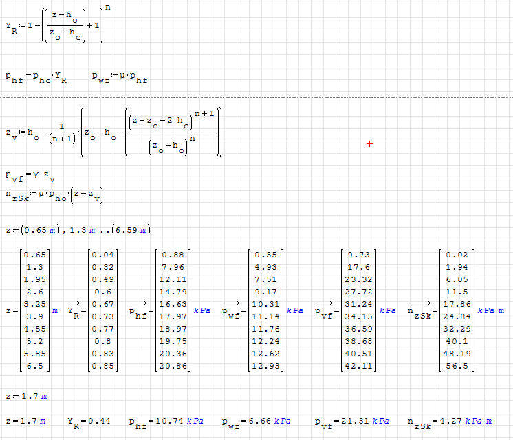

#3 Опубликовано: 24.08.2016 13:03:55
Two quick observed bobos: YR is not digestible and unit problem
Always plot before "I want this, I want that"
en 1991-4.sm (346,35 КиБ) скачан 1320 раз(а).

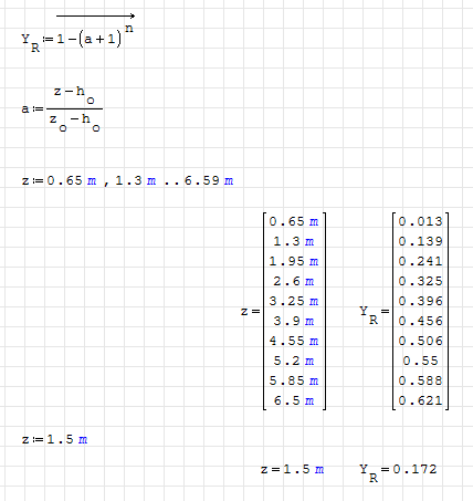

#5 Опубликовано: 24.08.2016 21:04:34
Hello Berk,
Just like this:
Berk Koç 25.08.2016 02:40:00
#6 Опубликовано: 25.08.2016 04:41:28
It is working with the vectorize function but why it should be like that? I couldn't understand. For example variable "a" has values when you press equal without any vectorize function.
In SMath while you are working with matrices "raise to power" it is a shorthand for matrix multiplication/inverse multiplication -> it works just when the exponent is an integer;
moreover when matrices are vectors (column matrices), instead of giving an error because dimensions of matrices are wrong, a special feature allows to the product to be the "dot product" (thus vector^power is the sum of its elements each one raised to power's value);
To apply scalar math to matrices/vectors you have to use vectorize(), programming (loops) or also you can use systems - sys(..) function.
Berk Koç 25.08.2016 04:48:00

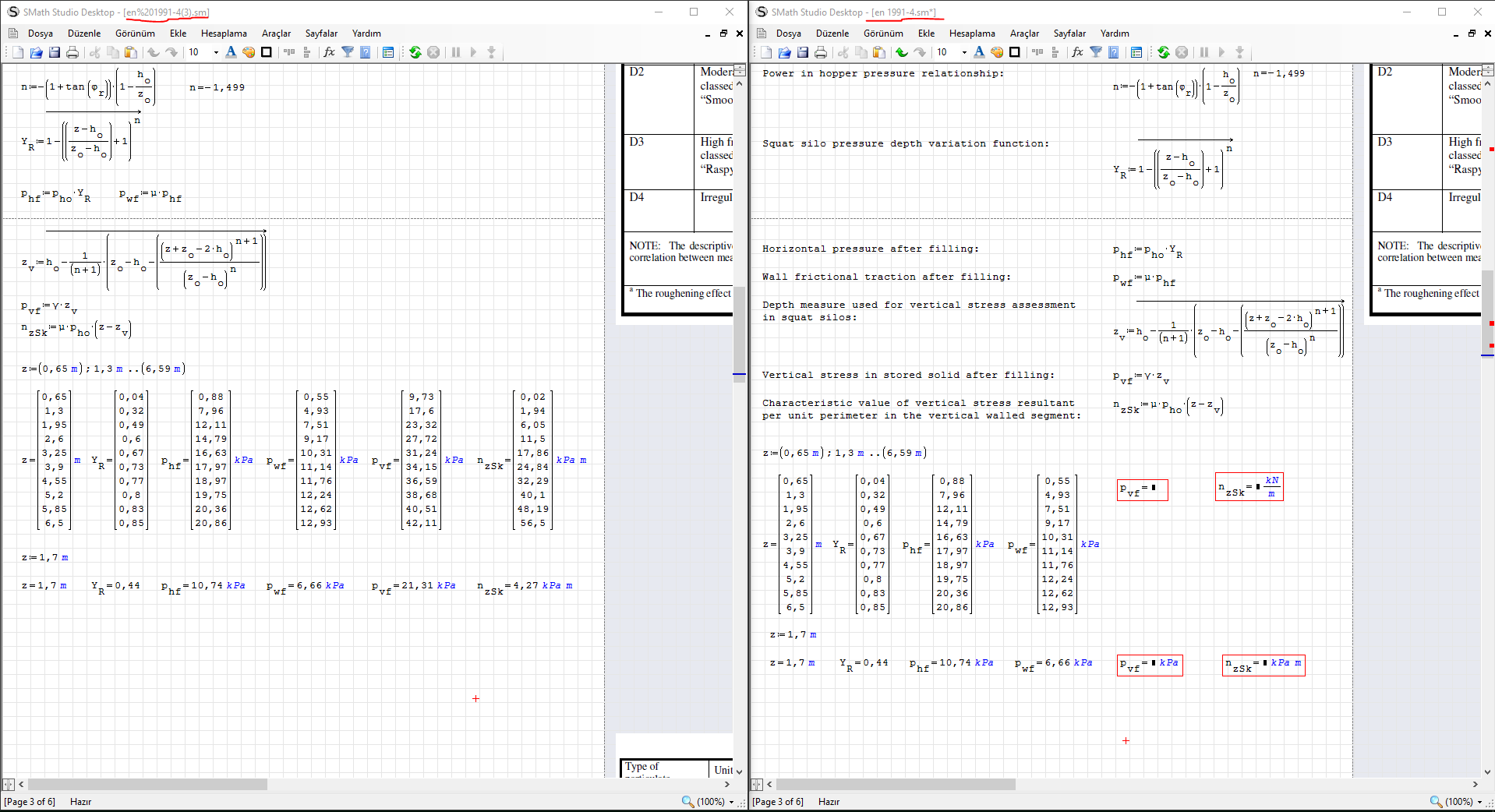

#13 Опубликовано: 29.08.2016 11:43:46
Berk Koç
Berk Koç
0 сообщений из 21 понравились пользователям.
Berk,
that's because of the order of declarations in your file. Please notice that Davide defined formulas first, and later defined the variables that constitute the formulas. This way, when the formulas were defined, the meaning of its constituents was undefined, so it stayed as is: names. When later below, after all variables were set, you tried to get the Y.R value, SMath took the formula for Y.R, substituted all variables in it with their already-known values, and gave you the result for this set of values. After that, you re-defined some of variables, tried to get answer, and SMath repeated substitution in the formula, giving you the new answer.
But in your file, you define variables first, then define formula for Y.R. This way, at the Y.R definition, SMath already knows all variable values, so it stores them in the Y.R definition instead of their names. All later modifications of those variables won't have impact on what is inside the Y.R, so you won't see new results.
But you may use functional syntax instead, something like
Y.R(z):vectorize(1-(({z-h.o}/{z.o-h.o})+1)^n)
, to be independent on the declarations order.
Thank you mikekaganski,
I am really confused because same things on the mathcad program works without any problem.
I have tried what you said in the attached file. I have put z range below the formulas. And I have created function of z with same variable ( both formulas are on the sheet now). But it couldn't calculate the results now with range.en 1991-4 (z).sm (602,6 КиБ) скачан 1286 раз(а).

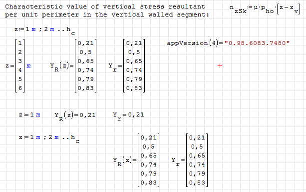

#14 Опубликовано: 29.08.2016 11:53:17
Mike Kaganski
Mike Kaganski
С уважением, Михаил Каганский
#15 Опубликовано: 29.08.2016 13:01:48
About your latest attachment:
  1. Set n optimization to numeric on his definition (possible issue on exponentation of unit to check from smath side)
  2. You have renamed Y.R to Y.r (lowercase) - restore it (there's no name's conflict between functions and variables) or update the name inside the definition of p.hf
#16 Опубликовано: 29.08.2016 17:50:20
Berk Koç
Berk Koç
Maybe it is about the version of the program. I understand that you have done nothing about the file that I attached. But it was not like this on my work notebook. Now I opened it on my own notebook and it works. The version is same as yourds. But I can't remember the work notebook. I will check it on wednesday but if it is not the latest one then it is the previous one.
Thank you.
#17 Опубликовано: 29.08.2016 17:54:11
Berk Koç
Berk Koç
Davide,
Thank you again, I just wanted to clarify that Y.r was just for demo. To try two methods simultenously. I have written that it is now working on my home notebook but I behave to early.
I have put two files tiled and screenshoted. As you can see all the things are same for both files (left is yours). But mine is not computing. I have just written the explanations of the variables only.

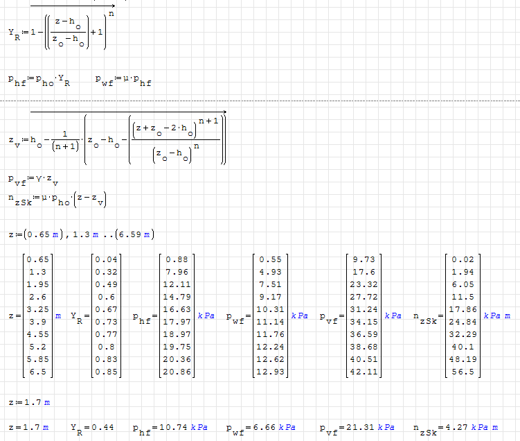

#18 Опубликовано: 29.08.2016 20:43:54
Mike Kaganski
Mike Kaganski
#19 Опубликовано: 30.08.2016 13:51:16
Berk Koç
Berk Koç
But I am really exhausted. I can't figure it. When I say "ok" now finally, then other issue appears on other place. I thank the author for this program as it is free and capable, I think I am not able to use it efficiently. I started to copy all the text and formulas to mathcad again which is a time consuming process but I can't find any other better way unfortunately.
Please see the attached 1 and 2.png sequentially and 3 and 4.png sequentially. As I understand from numeric, I entered "n" manually after knew the result, then it worked. All the calculations were done and there were no error. The expression at the bottom were ok. Then I deleted "z" value at top of the sheet which was entered to do a trial to see results. Then at the bottom, latests equations gave error.
I tried in another sheet with Y.R(z), it was good at beginning but then it gave an error again when the equations arise.
Файл не найден.Файл не найден. Файл не найден.Файл не найден.
