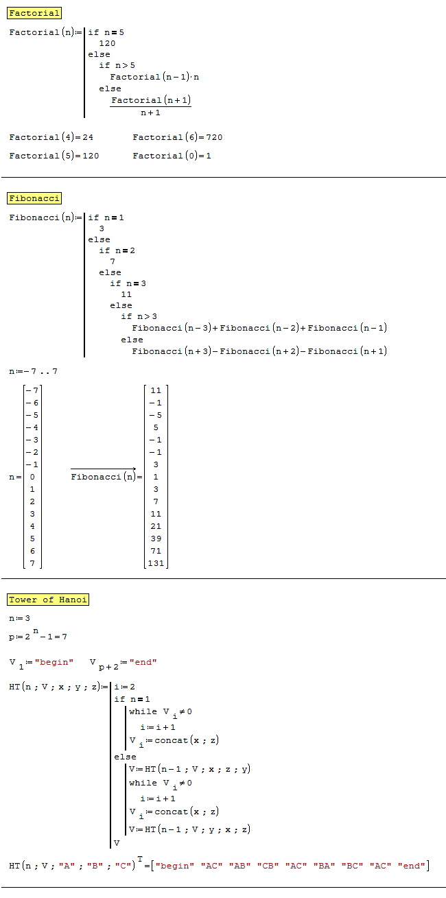

Three simple examples of recursion usage taken from this document: http://twt.mpei.ac.ru/ochkov/Recursion.pdf (created by V.F. Ochkov).

Regarding 3-rd example: solution can be tested here: http://www.softschools.com/games/logic_games/tower_of_hanoi/

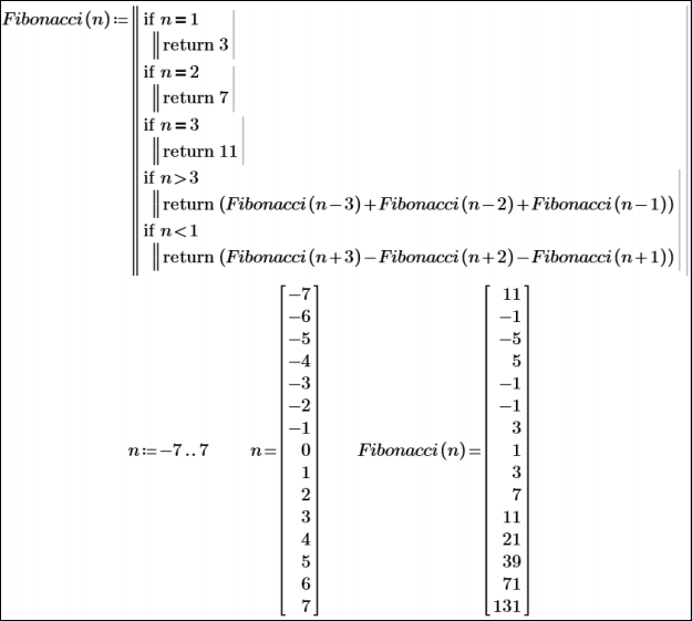

Regarding 2-nd example: as I mentioned, I took this example from the document, created by V.Ochkov. But I did a significant change against to the source - I've used vectorize function. Please see screenshot from referenced PDF:
What I don't understand, is why Mathcad gives correct result after call Fibonacci function with vector passed as an argument? How it determines that user wants this function to be called for every single vector element? Miracle!

Hello Andrey,
Thank you for your recent elevated activity on SMath
It is not a miracle. If you use an interval variable in Mathcad (n in this example is an interval variable - not a vector) then if you use a function and pass that interval variable to it, you will have the result of every element in that interval variable (Fibonacci(n)= ). There is a restriction here though. You can call that function, but you can not assign its result to a variable.

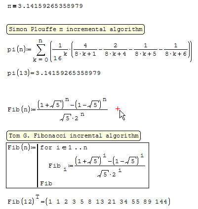

What you are saying Radovan is true, but NOT exactly: explain the nuance.
In Mathcad n:=1..5 is a "scalar vector". It will tabulate w/o rows
identification. It will not transpose as it does not exist as numbers,
just a "vanishing iterator" working when invoked.
Don't know how it is implemented in the Mathcad version Andrey is talking
about. Presumably it has Fibonacci built-in "Fibonacci(n)". It may have
two built-in algo: one giving Fibonacci(12)=144 ,,, and another one or the
same built-in around "IfIsArray". So, if given Fibonacci(12)=144
and for n:=1..12 it will run over each values of n=0,1,2,3....
thus tabulating Fibonacci(for each n)=1,1,2,3,5,8,13 ...
Fibonacci has a non-recursive form, something like pi from Simon Plouffe.
Pi [Simon Plouffe].sm (7,9 КиБ) скачан 1286 раз(а).
Davide Carpi 29.03.2016 18:14:00, Andrey Ivashov 30.03.2016 05:54:00
Thank you! Now I see... it is just another type of data.

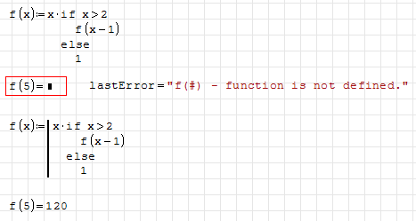

Two things I want to note:
  1. Over time, recursion has changed in SMath: in the past, it was possible to use recursion directly; currently it seems to require a programming function like line(), otherwise it reports "function not defined" error.
  2. Recursion isn't safe; improper termination condition that leads to infinite recursion will crash SMath. Try f(x):line(f(x),1,1) followed by f(2): (just remember to save your work first).
The latter indicates stack overflow, and absence of recursion depth checking. I hope that SMath will eventually implement a means of stack overflow protection, so that in such cases it will simply report "cannot evaluate: nesting too deep" instead of crash.
Also, it would be great if Andrey considered a kind of tail recursion optimization in the future.
