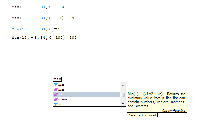

Min() and max() functions ought be overloaded to also accept multiple arguments (same functionality as Mathcad). Or provide an easy way to convert the old mathcad files.

Min() and max() functions ought be overloaded to also accept multiple arguments (same functionality as Mathcad).Or provide an easy way to convert the old mathcad files.

4. Max/Min value in matrix/vector

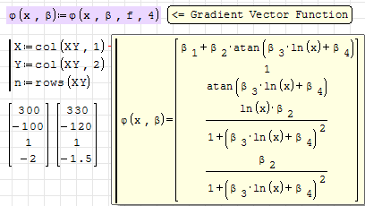

5. max/min of vector function(s) [example attached]

Genfit Rational Type J_6.sm (61,98 КиБ) скачан 1693 раз(а).
WroteDo you have that in Mathcad ... hover the pointer on the function.
... forgot to attach the document.
Genfit [HV_WEZ].sm (39,66 КиБ) скачан 1503 раз(а).

WroteMin() and max() functions ought be overloaded to also accept multiple arguments (same functionality as Mathcad). Or provide an easy way to convert the old mathcad files.
If you install the custom functions plugin, it includes functions that do this.

Example of Min/Max functions:
