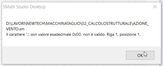

I've downloaded the latest version, but unfortunately I'still got an error during opening a file created with the old one.
Follow the screenshot....
basically says the "dot" character with hexadecimal value 0x00 at the first row is not valid....
Please someone should help me!
Thank in advance
Andrea

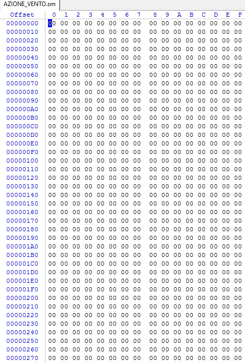

The file is completely filled with zero bytes. It is impossible to restore.
