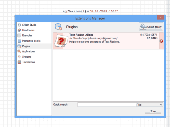

Text Region Utilities Smath Studio 0.99.7067.1585 - The region text utilities fail when installed in Smath Studio "0.99.7067.1585" - Сообщения
#1 Опубликовано: 24.05.2019 00:12:06
CBG
CBG
#2 Опубликовано: 24.05.2019 03:03:31
1 441 сообщений из 2 930 понравились пользователям.
Thank you, it is related with a change in the API and should be fixed in one of the next SS releases.

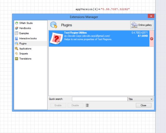

Hello Davide.
The new released version of Smath Studio 0.99.7057.32292 has the same problem as
the previous version 0.99.7067, and does not accept the Text Region Utilities plugin.
#4 Опубликовано: 30.05.2019 13:24:29
2 326 сообщений из 4 013 понравились пользователям.
Группа: Super Administrator
Fixed in latest beta (just released).

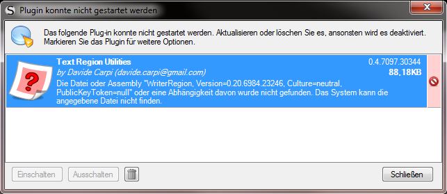

I just installed the latest beta (0.99.7100). I still get the message, that "Text Region Utilities" can not be startet.
It also did not work in the beta (0.99.7097).
System: Windows 7 x64
The program keeps telling me that "The file or assembly 'Writer Region, Version=0.20.6984.23246, Culture=neutral, PublicKeyToken=null' was not found."
#7 Опубликовано: 18.06.2019 08:52:36
do you have the latest Writer Region installed? (WR 0.20.7097.27665 in SS 0.99.7100)
#8 Опубликовано: 18.06.2019 11:21:49
flou_m
flou_m
Thank you very much for the advice.
After reinstalling the Writer Region Plugin (now 0.20.7079.27665) everything works.
