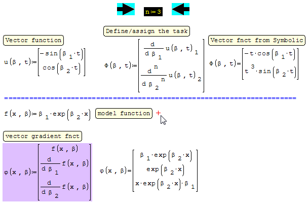

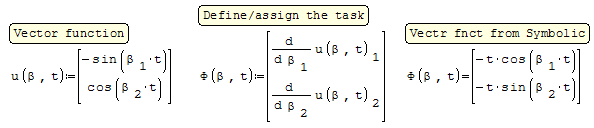

This is NOT unit vector. My understanding is that you want
a general procedure to differentiate a function vector.
This simple demo procedure is the core algorithm in Smath fitting functions
1. Genfit ,,,, 2. linfiCheby

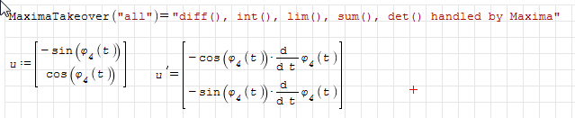

Here is another one. Maxima has generic vector-/matrix handling
diffm.sm (3,68 КиБ) скачан 1319 раз(а).
