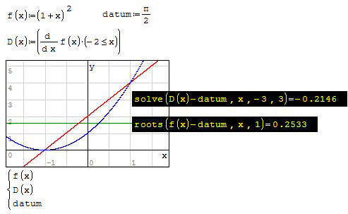

I have issues regarding diff function and boolean function.
I have been looking on different solution on the forum, but i have not found a related post.
How do you perform such calculation?

To obtain an answer, you are going to have to keep the boolean test out of your diff. equation.
Your equation would look similar to the following:

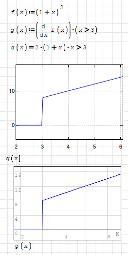

diff() function can't parse if original function has boolean expression.
Once derivative is completed result can be booleaned. (is this even a proper word
Here how it is.

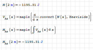

Yes. Use maple(diff(convert(M(x),Heaviside),x)) for convert SMath sign function into Maple Heaviside's. It looks ok now:
e7_5_3-hs ok.sm (139,5 КиБ) скачан 1426 раз(а).

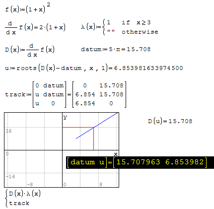

I have found a little workaround with late assignment.
heaviside_late_assignment.sm (9,12 КиБ) скачан 1416 раз(а).
I think it will be faster/cleaner once implemented than the atan solution.
Pierre
