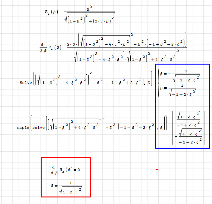

I want to get the real root in symbolic (in red frame) , but solve and maple solve always give me imaginary root (in blue frame).
Отредактировано 01.09.2025 14:15:20
#2 Опубликовано: 01.09.2025 18:09:17
The answer is correct. The appearance may differ.
The appearance can be normalized, but it doesn't work in this case.

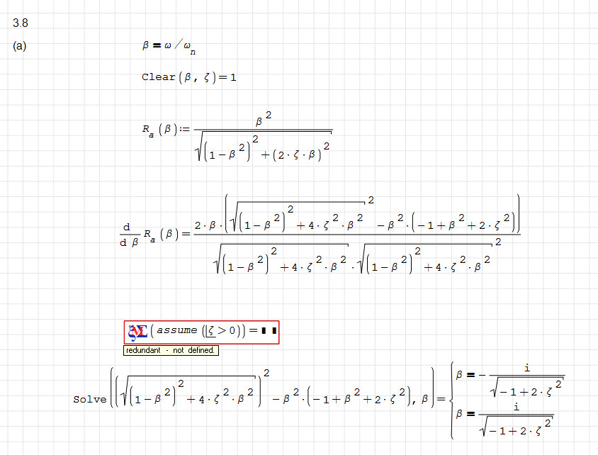

A simple option is force to find a real solution doing:
then...
best,
Oscar

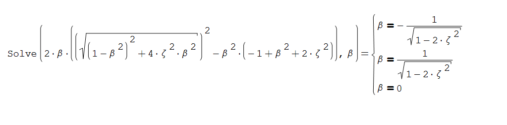

then...
best,
Oscar

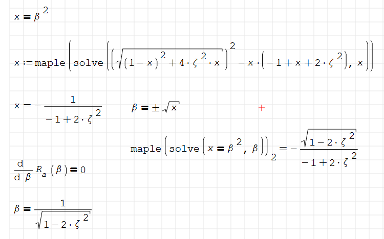

Hi. Using isol:
isol web.sm (223,27 КиБ) скачан 1279 раз(а).

@Oscar Campo
I can't get answer as you show in the pic. Please see the attached.
real root.sm (11,49 КиБ) скачан 879 раз(а).
