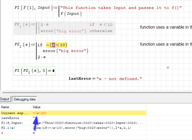

With some slight modifications on the names, you can see more clearly that the error is generated on the F1(2) preprocessing. Here x is passed as input to the first argument and if() fires the error.

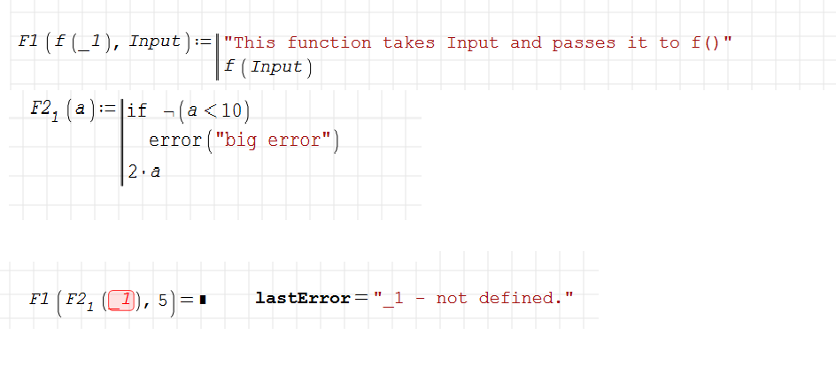

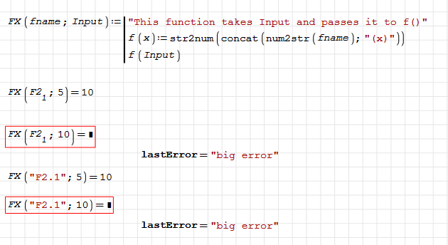

The only alternative that comes to my mind right now is the one below. You have to pass the function name rather than the function itself.
It is a workaround, and if you pass it as a variable, the variable itself must be not defined.
variablesInConditions_alt1.sm (11,58 КиБ) скачан 1638 раз(а).
(The attachment has a more complicated function just to make the string input independant from localization settings)

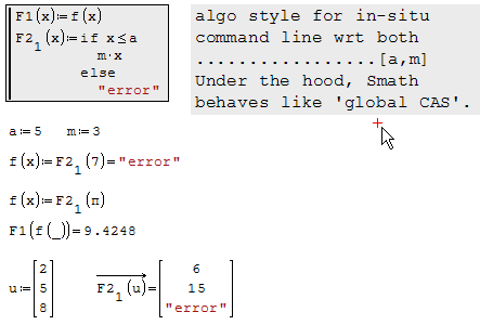

More instances of if/otherwise failed in program.
if/otherwise does not belong to the Smath kernel.
