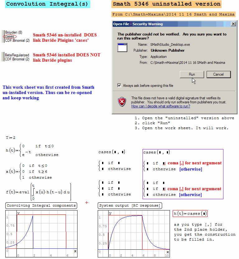

same using cases() + symbolic optimization
(still needs the annoying eval() for the integration)
2016-05-01 19_47_05-SMath Studio Desktop - [Convolution Integration (cases).sm_].png
Convolution Integration (cases).sm (22,92 КиБ) скачан 1591 раз(а).
#3 Опубликовано: 02.05.2016 11:55:26
Thanks Davide,
Works well with the uninstalled 5346.
The installed version does not have your "cases" from f(x) menu.
1/1 Mathcad, very elegant and neat.
Davide Carpi 02.05.2016 13:58:00
#4 Опубликовано: 02.05.2016 14:00:52
Thank you for your examples Jean, hope to see even more in future (even from other users).
Probably "Custom Functions" plugin is missing in the new version.
frapuano 02.05.2016 15:26:00

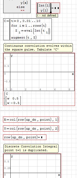

I get: u - not defined
SMath 5953
Basile
#7 Опубликовано: 03.05.2016 10:45:35
SMath 5953
Basile
... Davide might help in there !

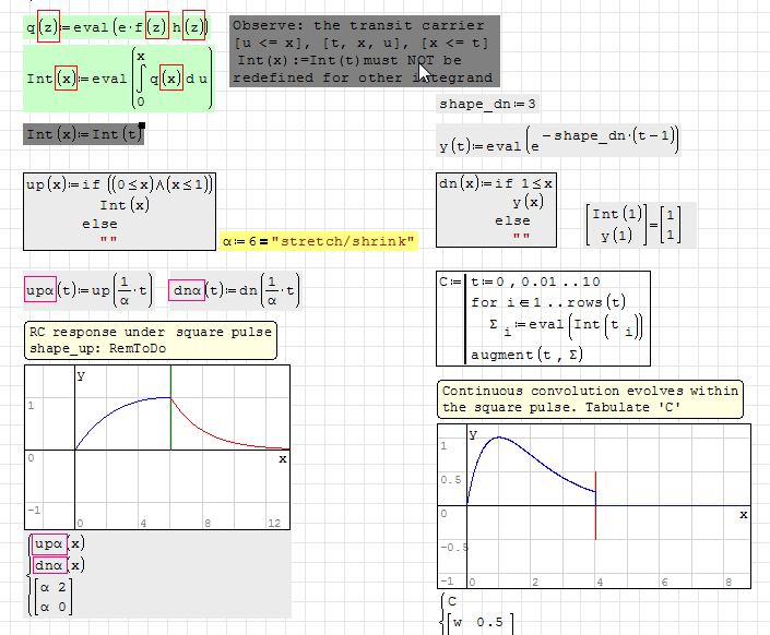

#8 Опубликовано: 03.05.2016 12:23:47
Apparently, there are a couple of hidden changes in the symbolic engine (both to investigate carefully )
- the first change involves the transit carrier (fixes in red boxes);
- the second change involves the definition of a function using the function itself in the RHS (fixes in purple boxes; 99% s bug, the function is defined in the dynamic assistant but cannot be evaluated - "function is not defined" exception bug reported as SS-2335);
FIX attached, works with both the versions (0.97 & 0.98)
2016-05-03 17_11_06-SMath Studio Desktop - [Convolution%20RC%20Integration.sm].png
ConvolutionRC Integration [0.98.5953].sm (40,61 КиБ) скачан 1408 раз(а).
#9 Опубликовано: 07.05.2016 10:34:03
Basile
Basile
8 сообщений из 172 понравились пользователям.
The simplicity of the previous version has become complicated.
but does not work. Any ideas?
Basile
#10 Опубликовано: 07.05.2016 11:09:27
same problem to me
Win7 64 bit
SMath 0.98 build 5953
Solved.
Interference with plugin Maxima
#11 Опубликовано: 07.05.2016 12:07:40

#12 Опубликовано: 07.05.2016 23:15:12
Ndtma, Sergio, Basile: the above explanation concerns your 5953.
It may also suffer the same logical link bug as 5346 ... like this again.
There are two versions of 5346: the installed version and the NON-installed versions.
Both have substantial differences in what the plugin manager links or does not link
wrt the f(x) menu. For instances: the installed version does link to the Matlab functions
mwxxxxx, the UN-installed version DOES NOT link mwxxx Matlab library, but does link Davide plugin for module 'cases'.
The installed 5346 DOES NOT link Davide plugin 'cases', does not link +++ stuff ...
Levenberg-Marquardt just to cite one.
All what I'm talking about is XP Home SP3. Something else to explore with other WIN OS.
Read again and again what I wrote, up until the brain responds. I know what what I'm
talking about, proof:
Works/does not work is not enough for designers. Prove your assertion(s).
