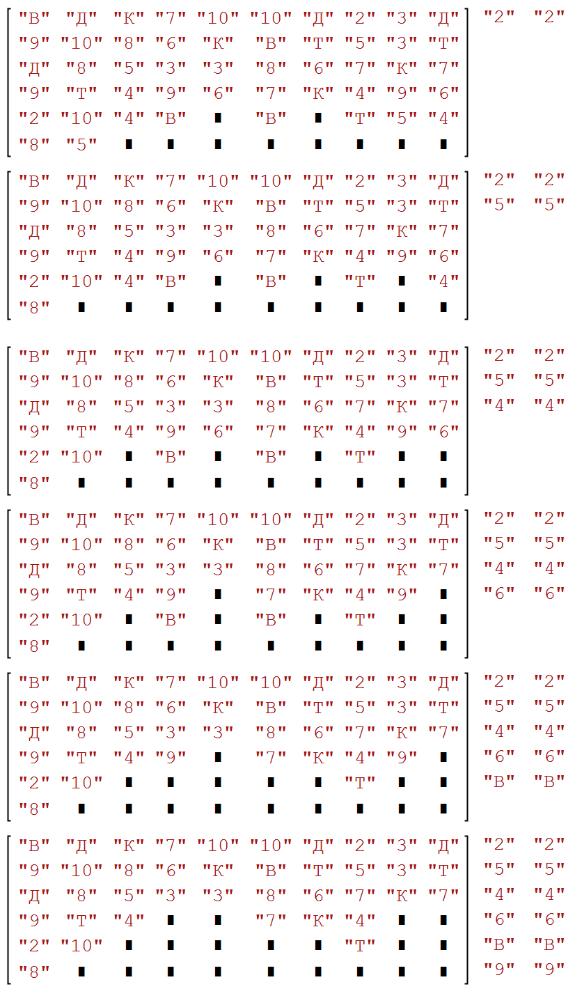

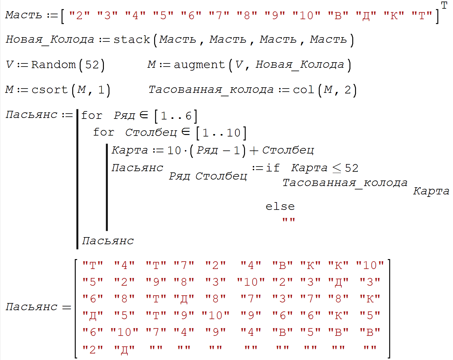

What is it with vector?
Patience.sm (37,01 КиБ) скачан 1572 раз(а).

Sorry!
It is one strange bug, I think.
Without the program - all ok!
Patience.sm (37,01 КиБ) скачан 1559 раз(а).

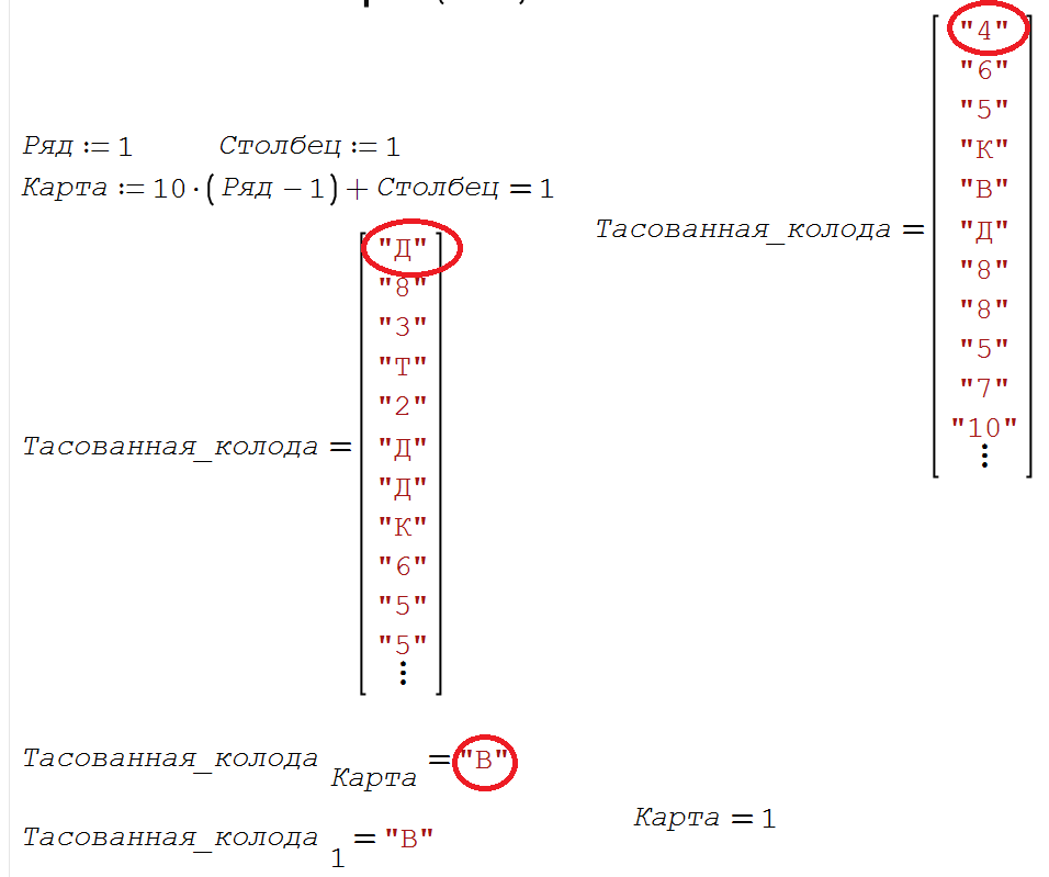

Greetings,
I wasn't able to reproduce the error, but it appears as if the Random() function is somehow redefining your variable every time you call "Тасованная_колода" to display.

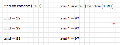

Hi. It's not a bug, but a feature. Use eval to pin up the function value.
