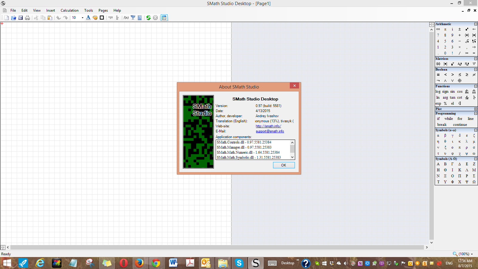

I attach the Insert menu and the Help>About.
Can I try something to help solve the problem?

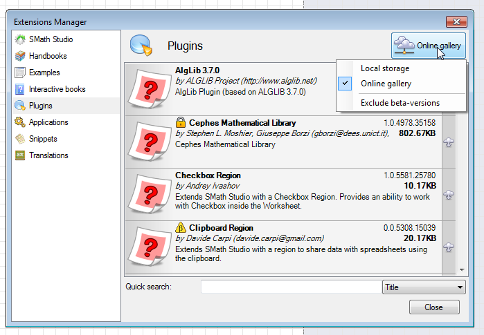

#5 Опубликовано: 07.08.2015 06:33:44

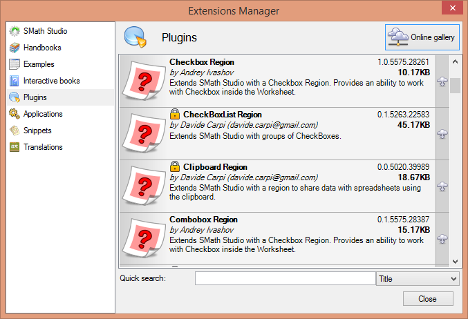

Looking at your screenshot seems you have just the built-in plug-ins (that is ok in a clean install). Have you tried to download a plugin from the gallery? (f.e. the "Checkbox Region" in the screenshot or any other Region plugin)

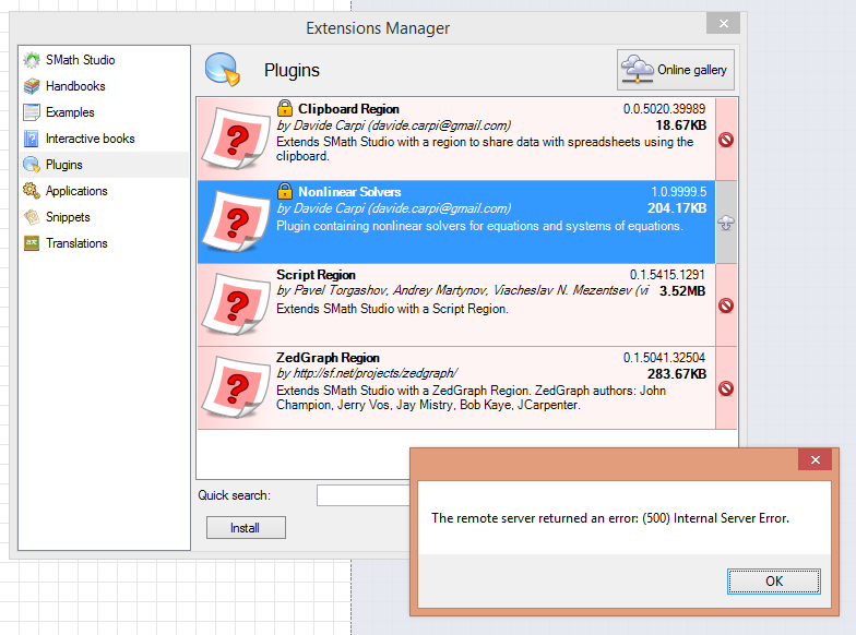

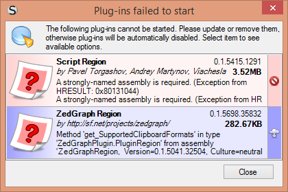

#7 Опубликовано: 08.08.2015 06:32:20
The "Installation failed" error of Script Region/ZedGraph is because these plugins are made for an older version of SMath Studio. If you are interested on them, you may ask the author (uni) to update the plugins.
The server error on Nonlinear Solvers may be related to a wrong password (here the correct one)
I have not encountered issues downloading Clipboard Region.

But the other three, I do not know what to do. The "Enable" and "Disable" Buttons are inactive.
Basile

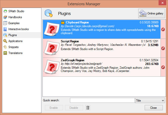

#9 Опубликовано: 08.08.2015 14:36:32

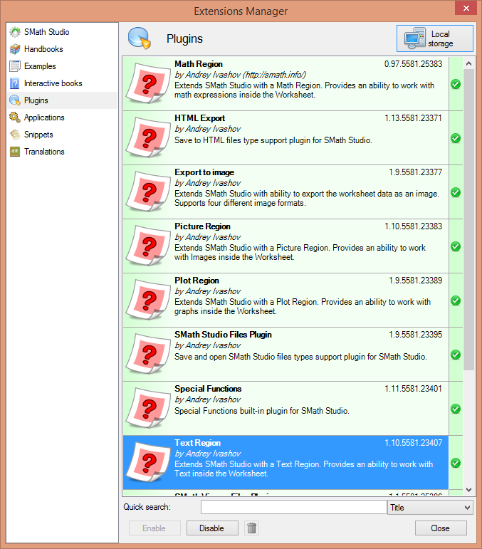

I don't know why but the Clipboard Region is a version not compatible with your SMath Studio.
You have to delete the plugin manually;
- close SMath
- go to the folder %APPDATA%\SMath\extensions\plugins\
- delete the folder 0e45de64-570b-4407-8352-6fb6ab358782
The uninstall button disabled may happens if you have installed by yourself the plugins in the SMath studio folder (Program Files (x86)\SMath Studio\Plugins)
In the latter case delete any non built-in plugin from that folder.
Then open again SMath and check the gallery, you should see the Clipboard Region version 0.0.5308.15039. If you still have the older version let us know.

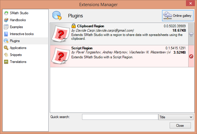

#10 Опубликовано: 09.08.2015 16:57:49
Basile
Basile
8 сообщений из 172 понравились пользователям.
"...you should see the Clipboard Region version 0.0.5308.15039."
When I am opening SMath I get another version. (SMath07)
"The uninstall button disabled may happens if you have installed by yourself the plugins in ..."
I did default installation.
When I start SMath, I get (SMath06)
Basile
#11 Опубликовано: 10.08.2015 01:31:45
Basile, ZedGraph and Script - these plugins haven't been updated properly. Some of my plugins are unstable (maple 5 probably). All other my plugins was updated yesterday. If you see another version this means that the author working on it.
#12 Опубликовано: 10.08.2015 06:07:26
Basile
Basile
The Clipboard Region still (after deleting the plugin from its folder)appears as an older version 0.0.5020.39989 instead of the newer version in the Extensions Manager>Online Gallery.
Attempt to install results in Installation failure.
Please, see icon in previous message above.
Any ideas?
Basile

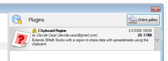

#13 Опубликовано: 10.08.2015 13:54:17

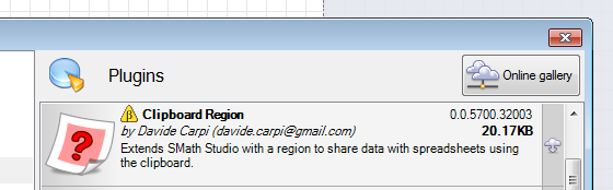

Because your is a full clean installation I suspect there's a server-side error, or some settings wrong with my previous upload...
I've recompiled and uploaded the plugin for the latest beta build (SS 0.97.5581), please check if this is available and works for you (ClipboardRegion version 0.0.5700.*)

#16 Опубликовано: 12.08.2015 10:16:52
The server contains all the plugins published. Each plugin has a target version (because the changes in the SMath core may add/remove features for the external plugins) and you should be able to view and download just the most recent plugin for your version of SMath Studio; therefore if you have the latest Nightly Build you should see the latest Clipboard Region and not the previous, while you should see an older version if you are using (f.e.) the latest stable plugin.
In your first screenshot pair (SS 0.97.5581) the most recent plugin (0.0.5700) is not displayed, I think just Andrey can solve this...
