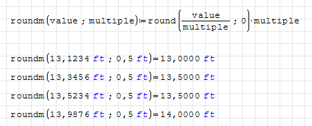

What I want to do is round to the nearest 0.5
if round(X,0) < X
X:=round(x,0)
else
X:=round(x,0)+0.5
This should give me 13 for 12.8 and 12.5 for 12.3, but it gives me 13.1234 and 12.6234 (units in ft)
round(value,n) rounds a value to the n-th decimal digit, what you are looking for instead is a function that rounds to a multiple of a generic number, and it is really easy to have it:
note that this works indipendently from your units system (just place 'ft in the rightmost placeholder if you are using imperial units with base SI system and vice-versa)

Thank you very much for an excellent response Davide.
