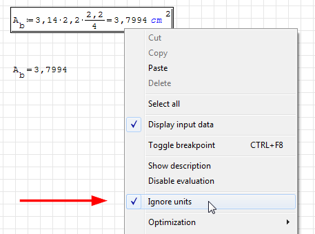

If your intent is just to display a result, or you want to make dimensionless calculations and assign manually the dimensions on the results, right click on the region and select "Ignore units", then this feature will be ignored

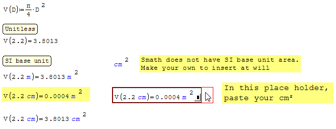

Otherwise you have to assign the units in the LHS, and eventually adjust the result (results are given in base units)

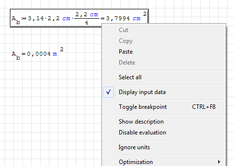

#3 Опубликовано: 02.02.2017 11:42:59
Like this :
