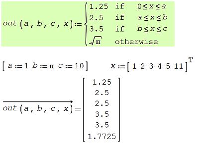

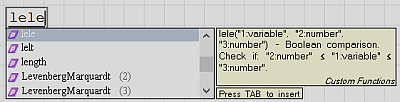

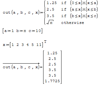

#8 Опубликовано: 10.11.2021 11:12:41
NDTM Amarasekera
NDTM Amarasekera
This way also, using lele function. Thank you Jean for the example.
Cheers
