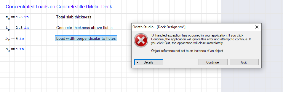

I'm getting an unhandled exception error when copying text regions by highlighting an existing text region and using the Control key + mouse to copy it. It does continue without crashing, and I can apparently copy by highlighting and using Ctrl-C and Ctrl-V, or by using the buttons on the menu bar. So far it only seems to be the Ctrl + mouse method of copying that used to work and doesn't in this build. Formulas still can be copied and pasted that way without error.

Thank you!
The reason of this error is the same as it is in the issue [USERLINK]Razonar[/USERLINK] mentioned above. Fixed now.
