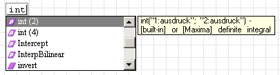

I don't see anything related to calculus.
#2 Опубликовано: 08.05.2014 03:01:01
1 353 сообщений из 2 266 понравились пользователям.
OK, let's try happy guessing based on near to zero information about what you actually see and what you expect.
You might try to type int or diff and see what choices the dynamic assistant can offer.
