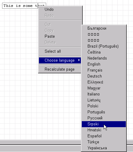

To enable the description, right click on the variable/function/plot and choose "show description".
When the description baloon is enabled, you can change the language of the description.
