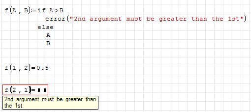

error(
errorMessage
) Shows standard SMath Studio error tip with text from the function's argument.
errorMessage
must be a string.
