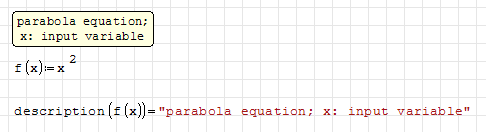

Descriptions allow you to document created math expressions on the worksheet; specified descriptions are visible in the Dynamic Assistance hints.
Descriptions supports multilanguage.

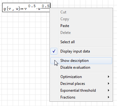

To enable the description, right click on the variable/function/plot and choose "show description".
show descriptions

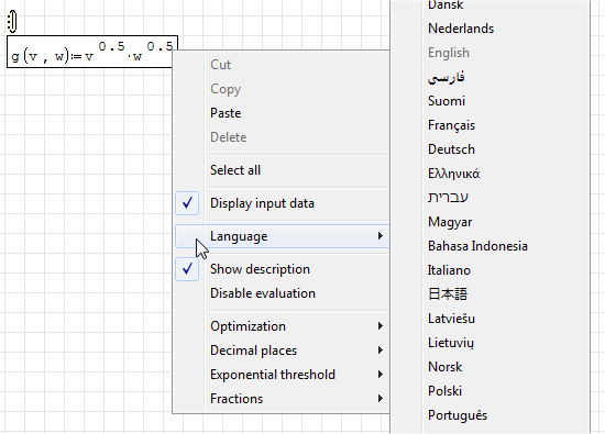

When the description baloon is enabled, you can change the language of the description.
description language

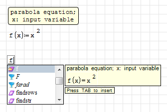

The description is visible in the Dynamic Assistance hints
Dinamic Assistance Hints
You can retrieve the description of your variables and functions using the built-in function description().

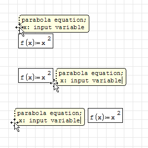

Left click and drag the left side of the description baloon to change the description relative position (left/right/top)
positioning
