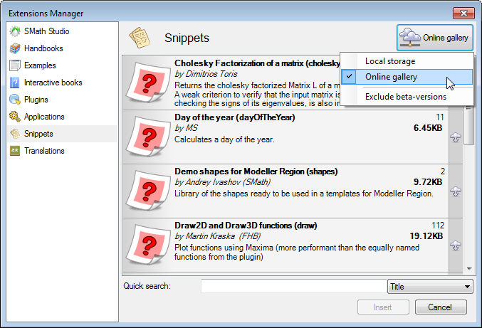

In the Snippet Manager it is possible to download snippets made by other users and shared through the Relase Manager; to do this, change the top-right button target from Local storage to Online gallery.
More snippets
The snippets downloaded through the Extensions Manager are stored in the user's folder %APPDATA%\SMath\extensions\snippets

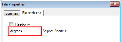

To make a *.sm file a snippet, follow these steps:
  • go in the File > Properties > File attributes menu and setup a Snippet Shortcut;
