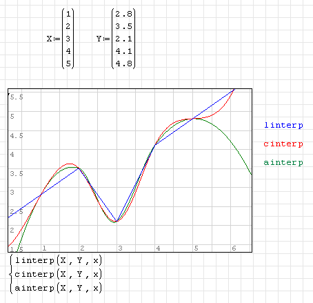

Here is the example of presenting these functions:
splines
Notice how misleading all of these functions are outside the limits of the original datapoints, ie below x=1 and above x=5. Try and make sure that you only use these for interpolation, not extrapolation.
You can have the X-vector sorted in ascending order:
X-vector ascending

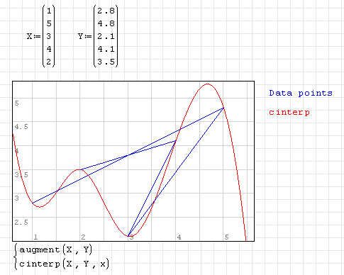

And also X-vector not sorted . As the main usage of the interpolation is to estimate y-value for the x-value not given in the table, this is not advisable:
X-vector not sorted
