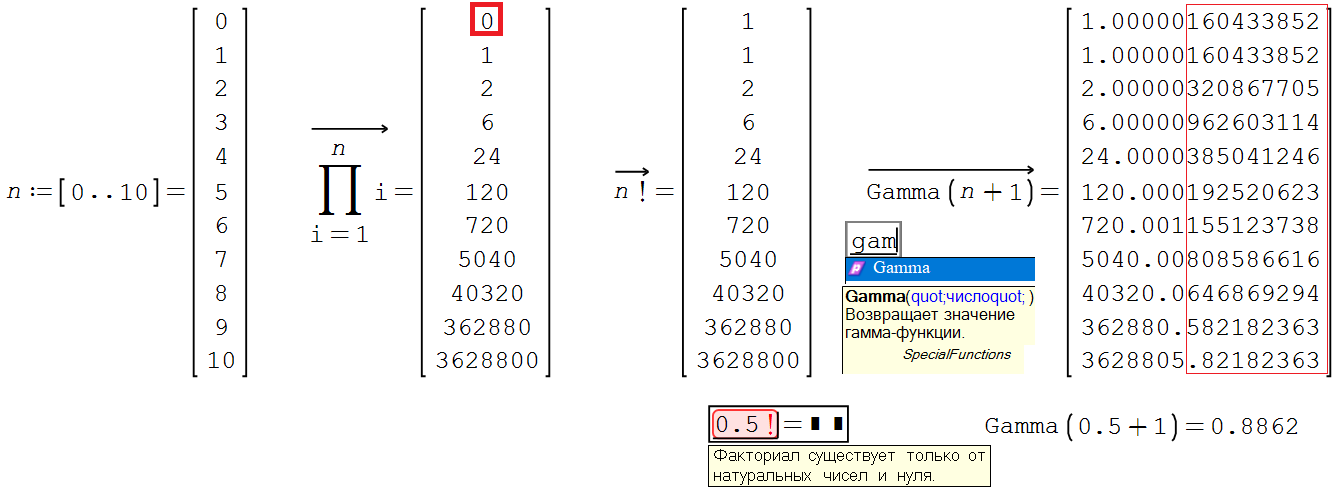

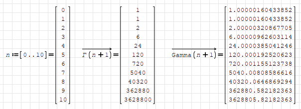

SMath Forum SMath Studio Bugs & Problems Gamma-function 1 Pages (2 items) Gamma-function - Messages Go to last post #1 Posted: 2024/9/19 21:06:29 Valery Ochkov 66 likes in 682 posts. Group: User 8-5.sm (6.49 KiB) downloaded 1375 time(s). #2 Posted: 2024/9/21 17:09:19 overlord 597 likes in 1,377 posts. Group: Moderator Gamma functions are broken. Not very accurate to be fair.Use sample functions either from myself or from Razonar's.Regardshttps://en.smath.com/forum/yaf_postst20338p2_Gamma-Functions.aspxgamma_r9.sm (36.93 KiB) downloaded 1513 time(s). <- My samplegamma.sm (27.93 KiB) downloaded 1572 time(s). <- Razonar's sample 1 Pages (2 items) New Posts No New Posts
