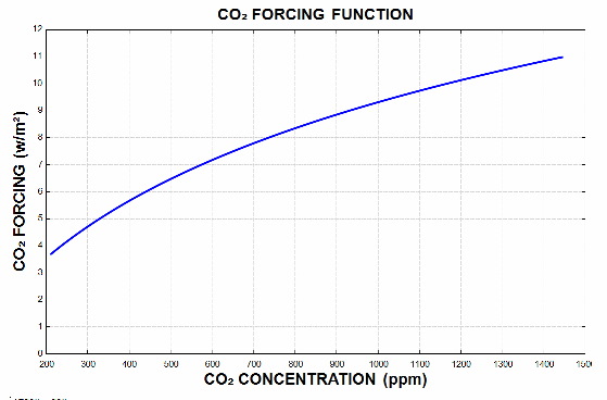

Does SMATH have the ability to click on a value in a graph plot to retrieve the x and y values?
This feature in Mathcad is very useful to find specific values.
For example, I would like to know the exact y value when x = 400 ppm on this graph.
Thanks
Reg

Hi Reg,
I guess that Davide is working on a plugin that can address your need, See this post.
Franco

Thanks Franco,
I’ll check it out. In the meantime time linterp is a reasonable workaround.

Or you need to use Engauge but it is obviously something not in the Smath environment.See link here
