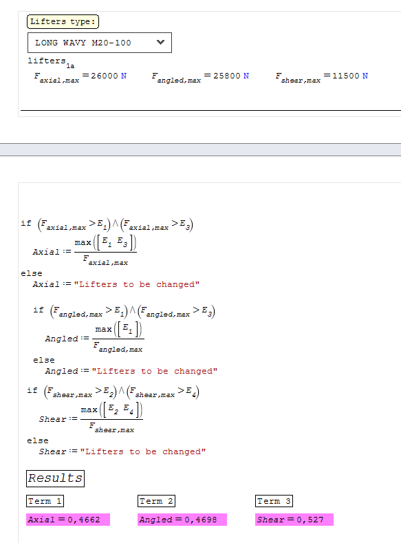

I am new in sMath topic. Can anybody tell me why here my combobox doesn't work correctly? It doesn't download values from rows.

WroteI have identified two errors:
1) you must assign a variable to the combobox
2) seems to have disabled the evaluation of the combobox
Sergio,
can you send me a correct file if it's not a problem?
I now what you mean but that will be the easiest way for me. I still have something incorrect.
Thanks for help
Thanks Sergio!
Unfortunately I have another problem. Combobox command "Requested element doesn't exist" and I can't find the answer. If you can, please check the file for me.

A possible way of use is as follows:
(I reduced the example to a minimum)
Restraint_bracket(sergio).sm (7.36 KiB) downloaded 965 time(s).
