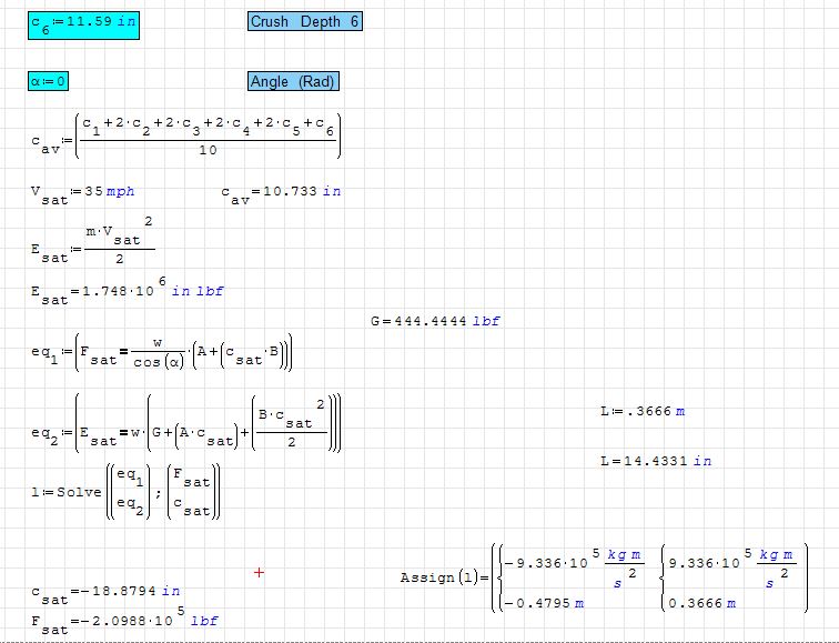

I've done this before, but I can't figure out what I've done wrong here. I have another sheet that I use regularly and it's set up very similar, but this one just won't Solve.
Any help would be appreciated.Trailer and Crush Energy.sm (18.07 KiB)已下载 1258 次。

Okay. I feel really dumb. I mistook my "W" for my "w". Unit analysis saves the day.
I'm still having issues though. After fixing the above issue, I need to force the positive solutions. I'm not sure how to do this. The positive solutions verify the test data I have.

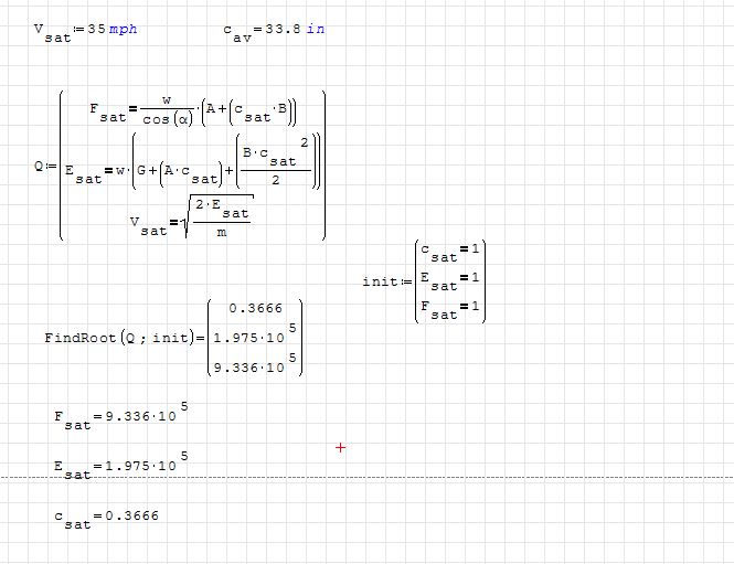

#3 已发布: 2016/11/12 03:00:50
983个赞,共6,866个帖子。

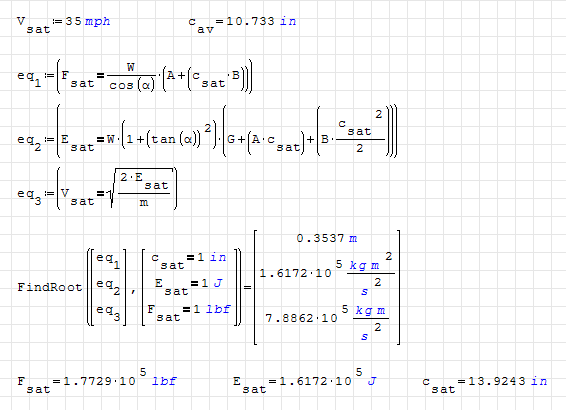

That's great. Thank you very much. I've got it up and working, but I'm having a disconnect on my units. The answers are correct as per my hand calcs, but they don't come out with units attached. If I click in and just add my units, it converts to the correct number, but the units are not correct. I went through and did a unit analysis, and I can't find anything wrong. Also the answers and units come out correct when I used Solve and Assign.

#6 已发布: 2016/11/14 13:22:22
1,443个赞,共2,936个帖子。
Just give the units to the initial values
2016-11-14 17_21_04-SMath Studio 0.98.6128 - [Traile and Crush Energy.sm_].png

Perfect! Thank you all for the help.
