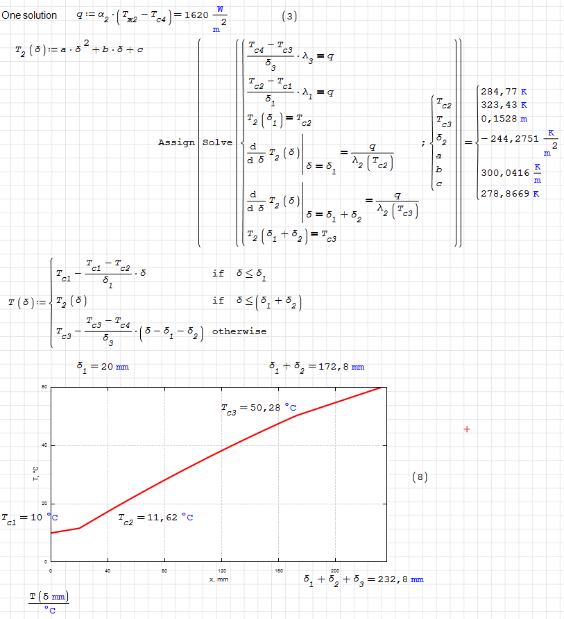

I am trying to plot a temperature field in a three layer wall. There is no problem with the outer layers. But there is a problem in the middle layer - there should be a parabola, not a straight line. How to draw this parabola in the simplest way - with one formula. I know the hard way.

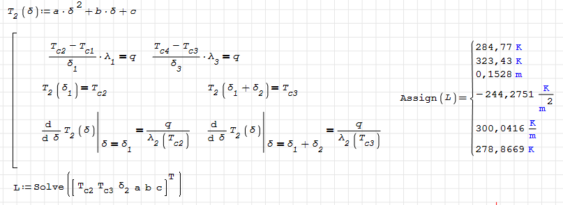

Don't know if that is the simplest solution.
Stenka-3-eng.sm (58.13 KiB)已下载 1424 次。

Fine!
And if the dependence of thermal conductivity on temperature is more complex, obtained, for example, through interpolation of discrete data. I would like to see an integral in the solution!

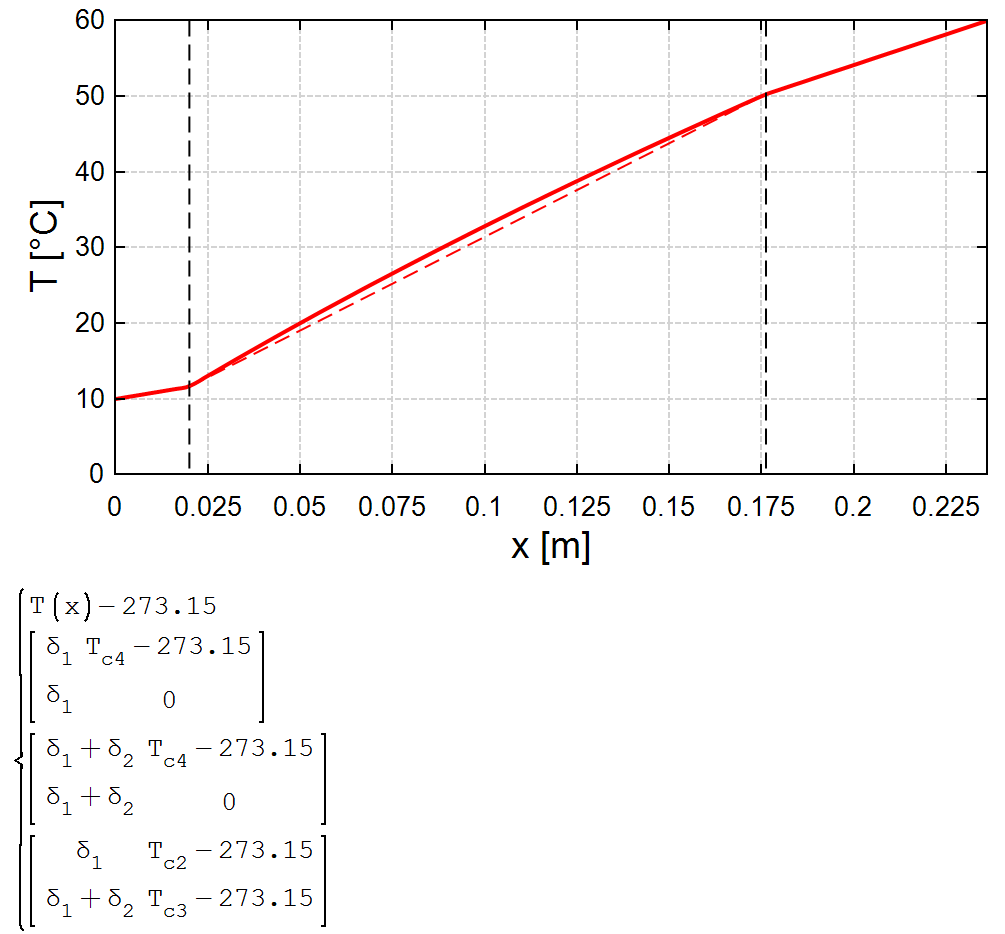

Version with mathcad block to collect the equations
Stenka-3-eng1.sm (59.5 KiB)已下载 1443 次。

One solution from Alan Stevens
Stenka-3-Alan.sm (60.35 KiB)已下载 1395 次。
