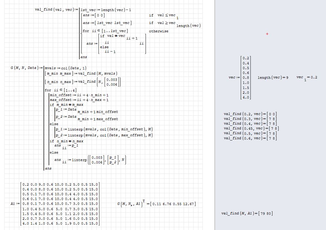

I've have a loop interpolating and searching for values. I not sure what went wrong, the loop is suppose to return 4 answer, however I am only getting (1), the last value.
Appreaciate some help and guidane.
Page7.sm (45.9 KiB) downloaded 1077 time(s).
Below you can find corrected file.
I have revised some equations in var_file() and G().
They were trying to reach out of matrix.
Since I don't have original mathcad file this is best I can do.
I did some error check but maybe you have to dig further.
File not found.
Tow Wai Lim 2021/1/28 10:50:00

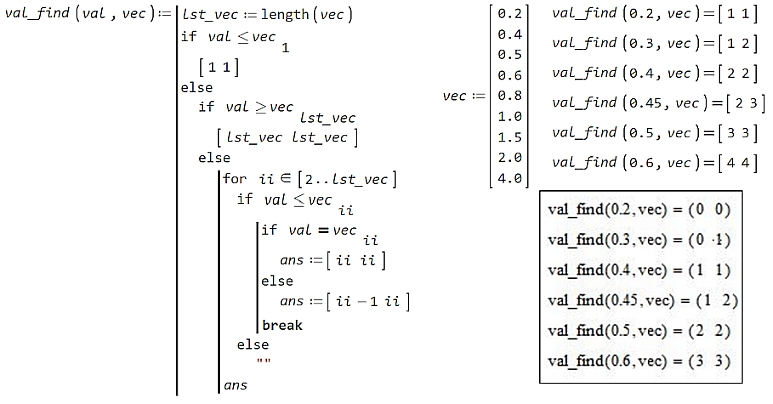

#5 Posted: 2021/1/28 09:23:25
1,106 likes in 1,784 posts.
Hi Overlord,
Thanks for the reply. Although the val_file() is not returning the same answer as per the attached MathCAD but the overall loop actual works.
Hi. val_find() returns the vector index, so it must to be the mathcad answer plus one, because ORIGIN:=0 in mathcad.
val_find.sm (134.2 KiB) downloaded 958 time(s).

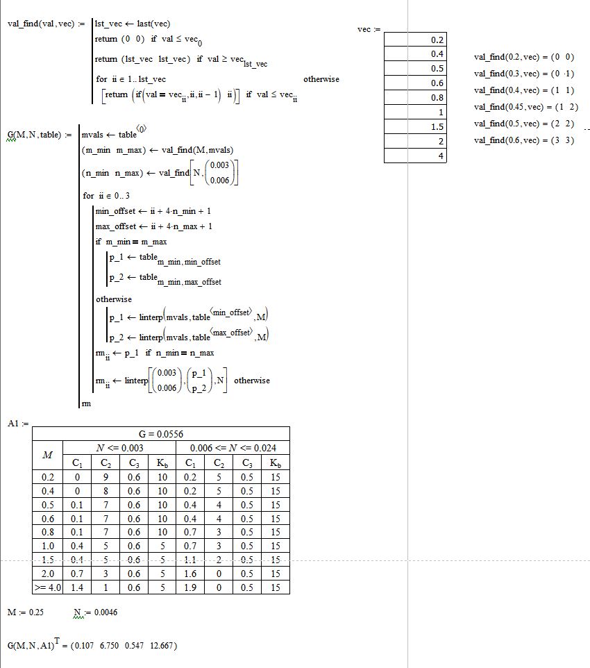

Page19 Search_Locate.sm (369.34 KiB) downloaded 882 time(s).
#7 Posted: 2021/1/28 10:48:40
Tow Wai Lim
Tow Wai Lim
0 likes in 42 posts.
Thanks Alvaro for your comment.
Jean, that is cool stuff... you can draw something like this in the SMath...

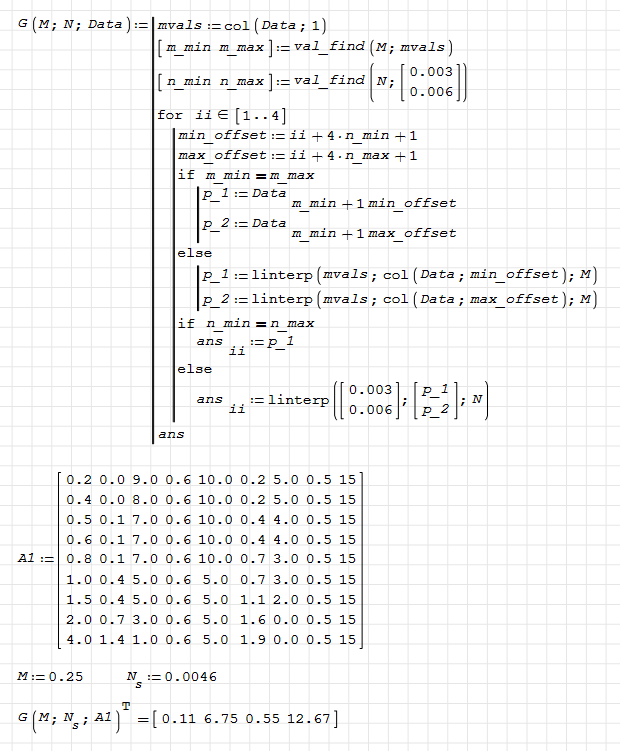

#8 Posted: 2021/1/28 10:54:19
597 likes in 1,377 posts.
Hi Overlord,
See attached calculation in mathcad.
Page 7.xmcd (97.02 KiB) downloaded 1125 time(s).
Having the mathcad file revealed the difference of two programs.
The problem is n_min and n_max in smath version.
Mathcad assigns them [0 0], [0 1] and [1 1] only, whatever you enter.
min_offset and max_offset can be calculated within bounds of 9x9 matrix by them.
By that, offsets are always lower then 9 during max_offset=ii*n_max+1.
Your current smath function will produce out of matrix.
Because n_min and n_max are [1 1], [1 2] and [2 2].
And by adding ii to them it will be bigger than 9.
Algorithm should be revised with respect to that.
n_min and n_max should be lowered by 1 to correct it.
You can find re-revised file according to this.
If anything is unusual you can tell, we will try to fix it.
Page7_re-revised.sm (47.13 KiB) downloaded 1070 time(s).
