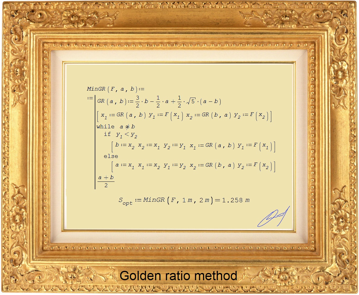

locate roots ... locate Min/Max ... evaluate Min/max.
Golden ratio QUICK 30405.sm (27.49 KiB) downloaded 1322 time(s).
