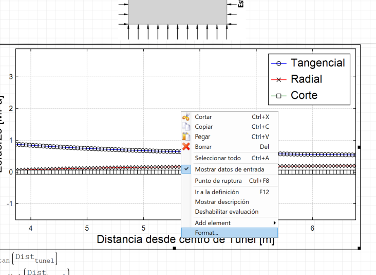

Hi everyone,
For some time now, I haven't been able to see the options under the "Format" menu when selecting a graph. The options simply don't appear, so I'm unable to change the scale, minimum and maximum values for the X and Y axes, among other settings.
Could you please advise me on how to resolve this issue?
Thanks in advance.
#2 Posted: 2025/7/2 06:33:49
1,544 likes in 1,859 posts.
The format window may be displayed outside the screen. You can try to bring it back by pressing the Alt and Space key combination. The menu that appears will have the Move item. Then you can use the mouse or the arrow keys to search for the lost window.
Another way is to find the configuration file (XYPlotPlugin.config) in the plugin folder and delete it when the program is not running. The window coordinates of the format window are stored there.
Edited 2025/7/2 06:34:39
4 users liked this post
Davide Carpi 2025/7/3 16:41:21, Miguel Navarrete 2025/7/3 21:13:08, Andrey Ivashov 2025/7/6 14:18:46, ⚜ Kenny Lemens, P.E. ᵂᴵ 2025/7/17 19:41:32
#3 Posted: 2025/7/2 07:41:45
1,441 likes in 2,932 posts.
A third way is to change the screen scaling, then bring it back to normal.
#4 Posted: 2025/7/3 21:19:57
Miguel Navarrete
Miguel Navarrete
1 likes in 2 posts.
Thank you for your help and answers. The “ALT+SPACE” option worked perfectly
