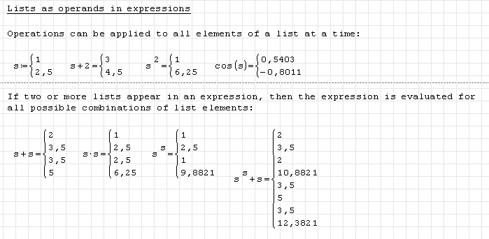

WroteNote that SMath does not return the correct result.
Lists and list operations are not a good representation for vectors and vector operations. If lists obtained by pol2xy are to be added, they must be converted to vectors using sys2mat().

I forgot to apply sys2mat to an expression involving more than one system, anyway the result of that sum is incorrect.
