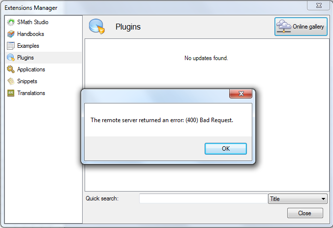

PSS. Once more to note the possible problem when frequantly installing/updating plugins from the Gallery (see the picture). If this happened, the only way is to delete the extension folder, and to install all the plugins again - AFAIK

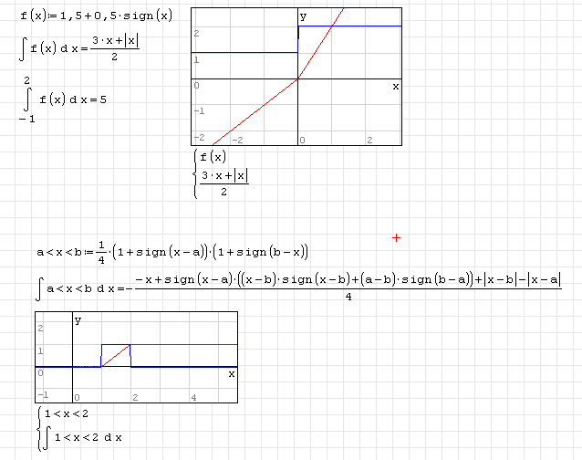

There is still quite something to do until we can symbolically integrate functions involving your operators. Maxima can do that only if the cases expand to sign() and abs() or possibly unitstep(). Perhaps we also could split the integrals appropriately at the interval limits and send the individual functions to Maxima.
The at() operator currently can handle just very special types of expressions. We could map it to the at() function in Maxima, see attachment. We did so with the det() function in the recent update (announcement to come)
Normally it is sufficient to delete the most recently installed plugins. Usually I have to delete the Maxima and the TableRegion directories.
I've never experimented the error in your screenshot, in the other hand the plugin updates sometimes (2 times, as for now) causes me workspace's "red cross of death" scrolling up and down worksheets ...
I see, I don't know how to fix this (because anyway I'm expecting the use of booleans in the conditions - see the screenshots)

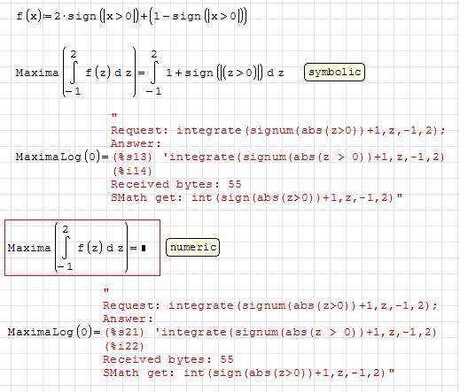

#5 已发布: 2013/11/24 16:00:08
1,362个赞,共2,276个帖子。
Maxima can integrate piecewise continuous functions, if they do not contain boolean expressions. Fortunately, there are workarounds for that. If you redefine the cases() functions in a similar way as apiecewise.PNG

I miss something... why this doesn't work?

#7 已发布: 2013/11/24 16:58:42
1,362个赞,共2,276个帖子。
Handling of boolean expressions is quite different between Maxima and SMath. The way I proposed is inspired by how Derive (R.I.P.) simplified piecewise functions 20 years ago.
You could use abs() instead of sign(), that might work as well.

I do not understand the expression sign(abs(x>0)). if x>0, then the boolean expression returns 1, otherwise 0. abs() does not change that, neither does sign().

Okay, the problem is that cases output conditions and statements without preprocessing, so there are booleans... Maxima can't add (as general rule) an is() when there are boolean operators, or, if this is not possible, overriding the cases function?
The sign(abs(#)) was to reproduce the actual behavior of the symbolic cases(), that use any 0 value as 'false' and any not null value as 'true' (mainly to skip the preprocessing of the conditions and to avoid scaling factors)

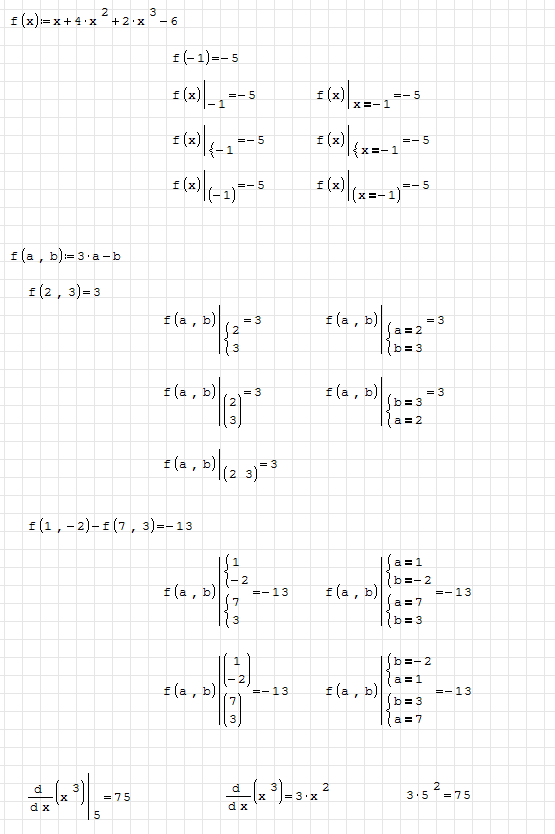

UPDATED
- at(2) and at(3) now are working functions
features:
* implicit equivalence needs a value for each variable, sorted alphabetically;
* with explicit equivalence (variable == value) the replacement could be limited to some unknowns or extended to anyone.
[edit] 1st post documentation updated

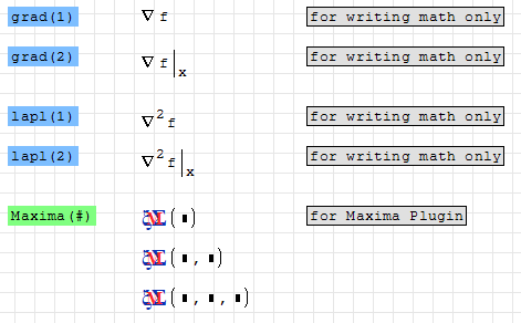

I'd propose to limit special formatting of functions to those cases that have a chance of being understood by non-SMath-experts or non-programmers. at(), cases() or the ternary comparisons are very good examples of this approach. That's why the range variables are that popular, because most engineers would understand the index equations.
How would you write your do() functions on paper? That might then inspire the "dressing".
