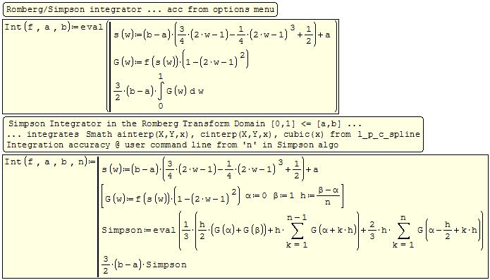

Quite right: The Smath integrator is Simpson.
Ranged accuracy [50 ... 10000]. Trivial cases are exact.
Two more exact cases are know 1/x [ln(x), b_spline].
On long range of the variate 'x' the Simpson/Romberg kernel
gives a much better result than simple Simpson.
Carlos adaptive algorithm is fool proof all cases.
You want these two proposed ... reply YES/NO.
As you can see, Romberg has the virtue of reducing the range of integration
in the [0 ... 1 ] domain. In two versions directly associated with the
Smath native Simpson integrator or Simpson algo style, thus integration
accuracy 'n' @ the user command line.
These two documents are like minimalist tool box.
Integrate Compendium_1 Romberg_FD_Adaptive [Carlos].sm (142.88 KiB)已下载 1088 次。
Integrate Compendium_21 Simpson-Romberg Merit.sm (138.06 KiB)已下载 1194 次。
