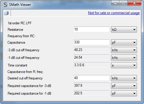

It's possible to make two converters, like this, one that calculates A from B and one that calculates B from A:
But is there any way to make a converter where changing any input updates the other inputs? So there's only one instance of A and one instance of B, and changing either of them updates the other? It would behave similarly to this:

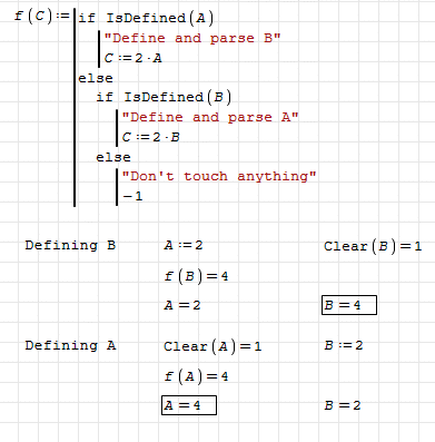

Hi. Something like this?
or
AfromB_or_BfromA.sm (13.01 KiB)已下载 1198 次。
