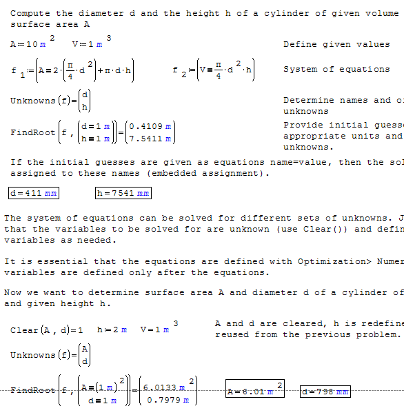

Radovan, thanks for the demo video of the handbook.
Handbook updated (file in first post exchanged)
- Added page "Howto add linked handbook pages"
- Added templates for handbook pages
- minor corrections and added function descriptions.
I cannot reproduce the solver problem in the screencast. The default precision is 4 decimal places, whatever that means: 4 significant digits (would be the preferred and only unit-independent variant) or an epsilon setting of 10^-4.

One minor observation. I still do not understand why I should use CTRL+click for using the links, while in the Reference Book just simple mouse click will do the thing. Keeping the finger on CTRL button while browsing the files and contents is not quite appealing.
About the FindRoot() in your example. I do not know why I get different result (Win7 64bit), but I messed up with different Nonlinear Solvers by Davide (some of them were totally unofficial). I think we should not worry about this at the moment. We will see when Davide announce the official version.

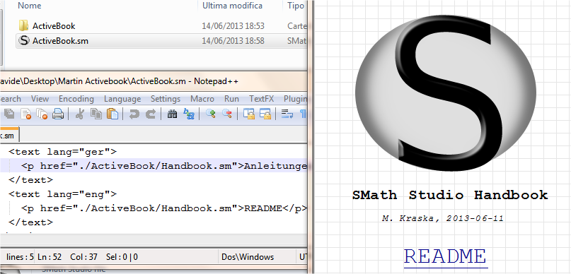

#5 已发布: 2013/6/14 09:48:34
1,443个赞,共2,936个帖子。
Hi Martin
First of all, wonderful job, that's the most closer attempt to a SMath's embedded guide
2nd (@Andrey) I think that an additional attribute could be added to enable/disable an "Handbook mode"; f.e. that option can enable the toolbar that you have provided for the reference book
3rd (@Martin) IMHO, as for now, a tree-based structure for the files is needed (at least a simple double level structure) to make the Handbook file easier to find (I've attached a couple of screenshots); in the other hand if Andrey found a better way to handle SMath's handbooks, an additional attribute "Handbook root" applied to the main file would be enough
Best regards,
Davide
Strange, this is not happening on my Win7 32bit

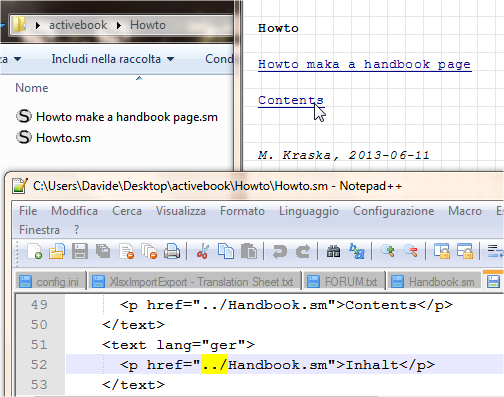

#10 已发布: 2013/6/14 12:50:20
1,443个赞,共2,936个帖子。
For now, the need to find the handbook root is mitigated by all pages having the back link included.
I've seen now your video, I do not understand from where the initial results come...
