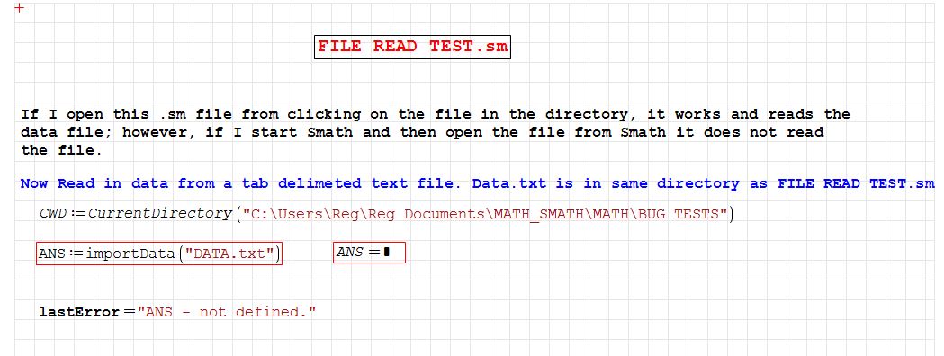

If I open this .sm file from clicking on the file in the directory, it works and reads the
data file; however, if I start Smath and then open the file from Smath it does not read
the file.
未找到文件。未找到文件。
data file; however, if I start Smath and then open the file from Smath it does not read the file.
Something you are not going correct:
1. Copy the DATA from your download
2. Paste in your Smath file directory
3. close session ... open Smath session
4. address the CWD:=
5 read back

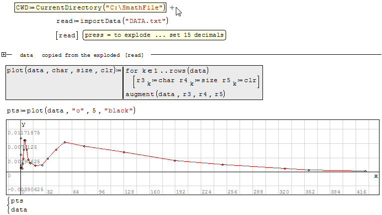

... like this:

Your data are in the document cw with the plot.
You can inspect down to lower values of X,
but going for too low values it will crash Smath
in the too low values of X around 0.0000XXXXX
Your lowest value is 0.000000000000XXX
At so low values crash. Smath does not plot
at so low values and crash
File READ Txt.sm (13.22 KiB)已下载 1326 次。
