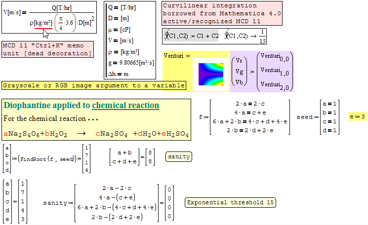

Wroteit is not just a matter of cosmetic
That's the point: chemical reactions are so much involved in maths
that it is already a task force to convert from quite a few dedicated
software [typical from ChemEng in VB]. Cosmetic in text from Writer is OK.
for the remaining: just maths from maths.
Can you imagine Unicode in the attached ?
Jean ... however Bravissimo for the effort, Franco !
Inst_pH Solution.sm (46.8 KiB)已下载 1294 次。
