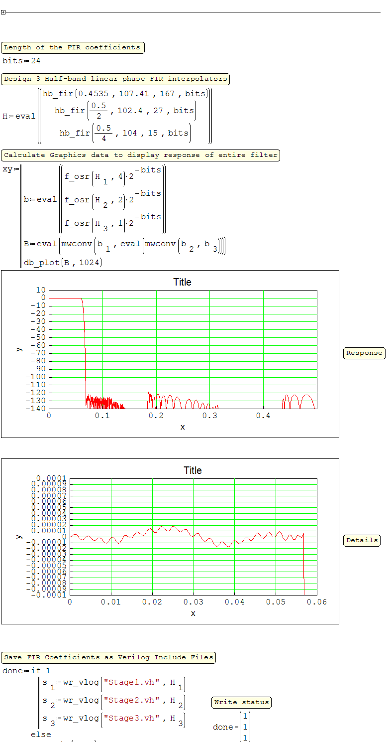

This is my remez2.dll. Usually it works a little better than Matlab tools.
You can design FIR band-pass/stop filters up to length~2000.
The example is audiophile's "holy" NPC SM5842 8X interpolating digital filter.
Before starting the program, do not forget to put remez2.dll in the plugin's \userefi folder.

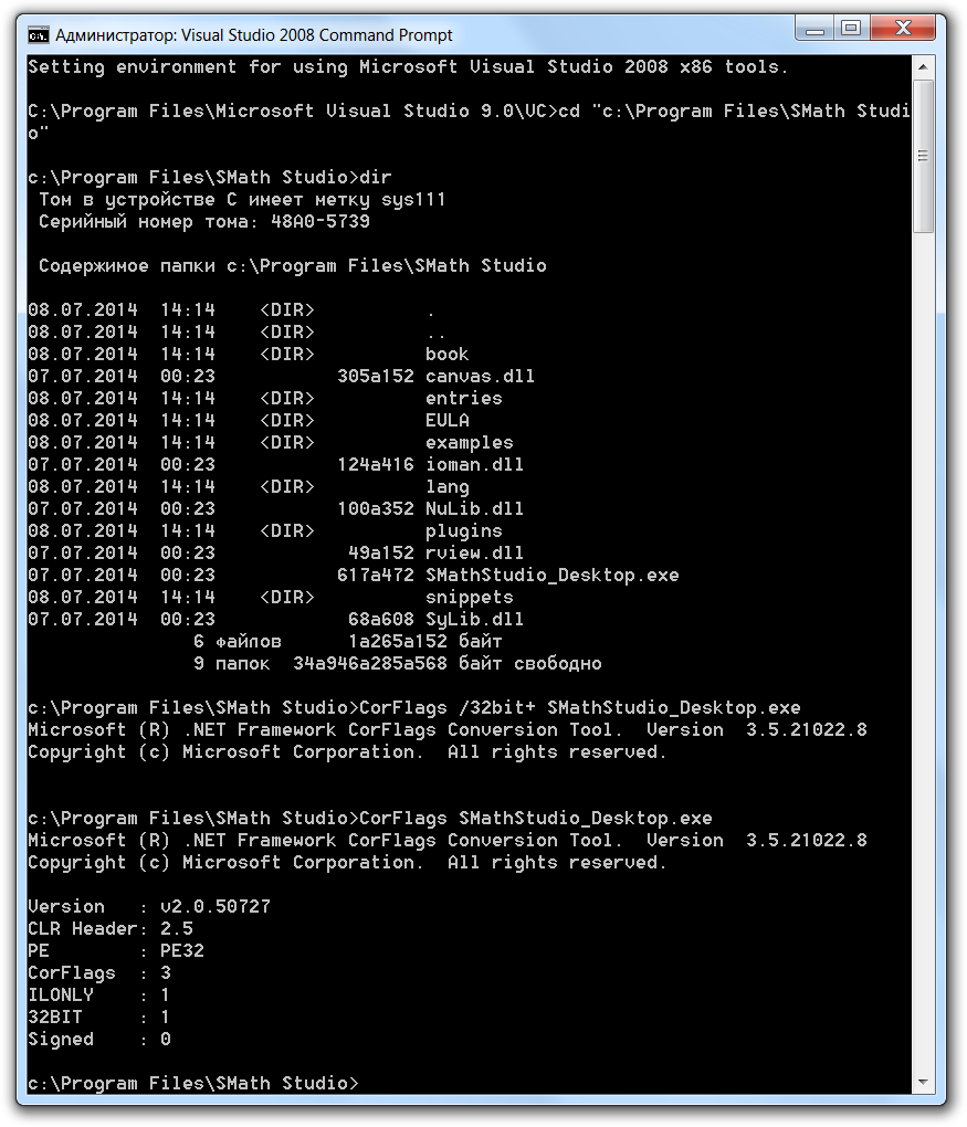

SMathStudio_Desktop_0.97.5189_32bit
How to get this 32-bit version (MSVS2010):
CorFlags /32bit+ SMathStudio_Desktop.exe
2位用户喜欢此帖子
I'm not a programmer, so VS2010 is not a good option. Simple patch is preferable
So far the flags bits are at the same location for all SMath versions.
Just use HEX editor to write one byte 0x03 to absolute address 0x00000218 in the SMathStudio_Desktop.exe.
Good luck !!
Good luck !!

Hi uni,
I downloaded the CorFlags but I don't understand what I'm supposed to do with the contents. It appears that your example was run from the command line but that didn't work, see below.
C:\Users\Harvey>C:\Users\Harvey>C:\Program Files\SMath Studio>CorFlags.exe /32bit+SMathStudio_Desktop.exe
'C:\Users\Harvey' is not recognized as an internal or external command,
operable program or batch file.
Since I am not a developer, I need some step by step instructions. I have looked through this topic and I don't understand the procedure.
Eventually I hope to get the Prode Properties dll to work.
Sorry to be so clueless.
Step 0. Copy CorFlags.exe to the program folder.
Step 1. Start command console with administrative privileges.
Step 2. Move to the program directory:
Step 3. Set the 32-bit flag to 1 (don't forget about spaces):
Step 4. Check the flag value (32BITREQ must be 1):
Result:
Command to return back 32-bit flag value (32BITREQ must be 0):
cd "c:\Program Files (x86)\SMath Studio"
CorFlags.exe /32bit+ SMathStudio_Desktop.exe
CorFlags.exe SMathStudio_Desktop.exe
Result:
Version : v2.0.50727
CLR Header: 2.5
PE : PE32
CorFlags : 0x3
ILONLY : 1
32BITREQ : 1
32BITPREF : 0
Signed : 0
CorFlags.exe /32bit- SMathStudio_Desktop.exe
