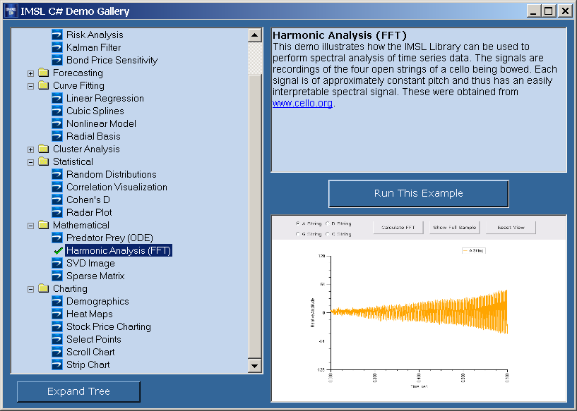

There are well-known IMSL® Numerical Libraries. Many people use this library, but it is commercial. This library exists in different versions (c# one of them). It can be used to extend SMath Studio.

I used it long time ago. I remember IMSL FORTAN routines on some VAX machine, more than 20 years ago. Than on some Fortran, MS Power Station 4.0 and Digital,Compaq Visual Fortran, some 10 years ago (sometiimes used NAG as well). I have'nt been using it for a while (10 years or so). Some of them are free. Many years ago I poked into Netlib free library (Fortran company). I switched to some more "light weight" software . When you said that it can be inside SMath, I believe you - but it seems to me like a "science fiction" .
