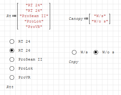

Sorry I was on mobile yesterday and I've assumed it was a missing fix.
I cannot reproduce on windows too. What SMath Studio and plugin versions are you using?

I am using Smath version 0.99.7822 and RadioButtonList plugin 1.0.7784.26230.
In a new one, I already try but here is the error again:
#6 已发布: 2021/12/7 14:27:42
1,443个赞,共2,936个帖子。
Latest plugin version for your SS should be 1.0.7831.2550. Please check in Tools > Plugins... For the bluish plugins there is an update available.
