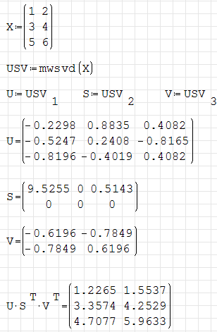

1,558个赞,共1,868个帖子。
Updated. svd() added, but I'm not shure about how it works (correctly or not).

325个赞和1个踩,共2,052个帖子。
I think something is wrong here. U matrix has extra column and S matrix should bi diagonal.

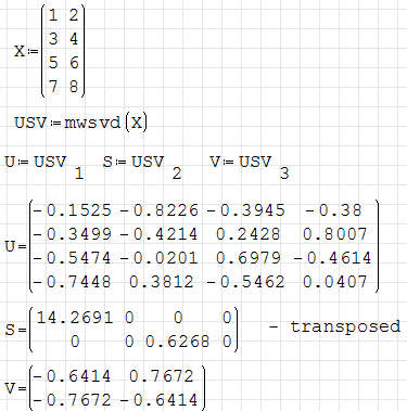

1,558个赞,共1,868个帖子。
Matlab svd example. S - transposed (I don't know why).

1,558个赞,共1,868个帖子。
Updated. svd() fixed.
I see. Thank you uni. I thought on [U,S,V] = svd(X,0) only.

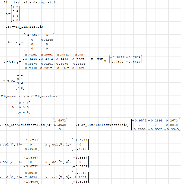

By the way, there is Dot Numerics plugin - by uni
