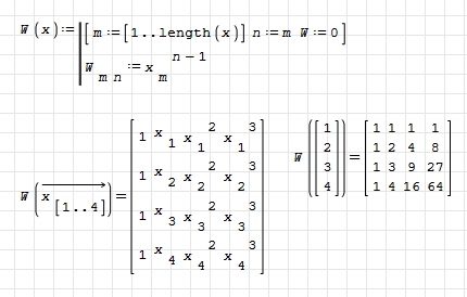

is there an inline-variant of the loop mentioned in the picture,
loop
because when i try to add an index to the function w(x) it throws a syntax error.

Hi Crang. This could be an option
VandermondeMatrix.sm (6.99 KiB)已下载 1257 次。
Make it algo style for infinite local use.
Cheers ... Jean.
#4 已发布: 2022/5/25 19:38:47
983个赞,共6,866个帖子。
... make Vandermonde algo style for any local symbolic/numeric
