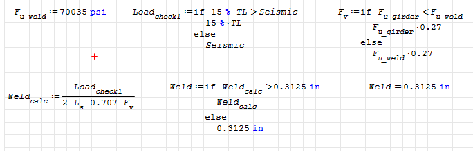

Does smath have a built-in function that performs the Mathcad min() and max() ? I see in smath, these function names exist but they are being using for matrix / vector functions. The code in Mathcad is this:

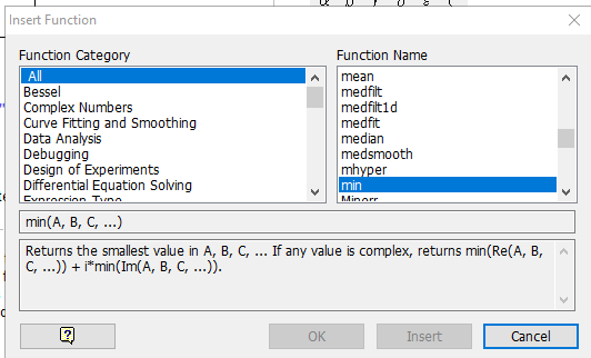

Seismic, TL, and Ls, are all numeric variables with units elsewhere in the calculation sheet. min() function description from Mathcad:
I could solve this programmatically a couple of different ways, but I wanted to check with the community before writing a work around. Several engineering codes require minimums / maximum values if the calculated requirement falls below the minimum / maximum respectively. This is an example of two such a cases.
Another option is to write my own function and re-use it, I am just not exactly sure how to achieve that.

I appreciate your quick reply. I had developed my workaround before I read your guidance:
Cumbersome, but it works. Then I did what you suggested which was just to define my varibles in simple vector form:
Much cleaner! I tried pressing the "Thanks" button, but it keeps giving me an error message (using Firefox 76). So, thank you

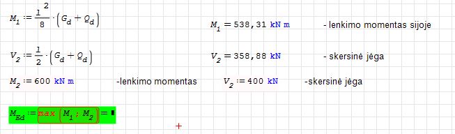

#10 Posted: 2020/11/24 14:59:25
