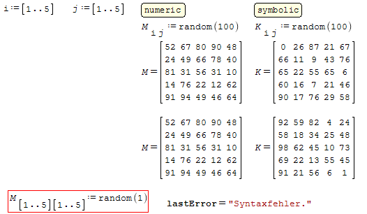

Why is using a vector instead of a vector-valued variable a syntax error?
indexvec.sm (5.16 KiB)已下载 1250 次。

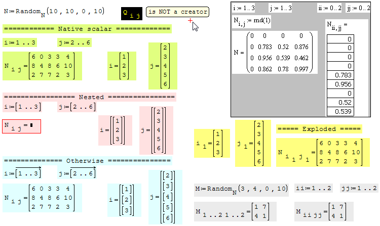

In Mathcad [7 <= 11] ... N[i,j is a matrix creator,
In Smath N[i,j ... is NOT a matrix creator.
Besides this distinction, Smath handles all related stuff much easier/naturally
A good example is "Utilities Matrix Locate Array1 Array2.sm" posted yesterday.
Smath spits out this project in two pages compared to Mathcad 5 pages
5 pages very hard to follow for the non-familiar user.
On the other hand, Smath can't render Mandelbrot as nicely as Mathcad.
The cannon that shoots flies is too small for shooting elephant ... never shoot elephants !
Utilities Matrix Creator_Exploder.sm (32 KiB)已下载 1267 次。
What do you mean by "matrix creator"?
I can easily use M[i;j to define (create?) a matrix. This just doesn't work with anonymous vector constants.
indexvec1.sm (9.36 KiB)已下载 1248 次。
#4 已发布: 2018/3/1 20:38:07
983个赞,共6,866个帖子。
That feature is not coded Smath 6179
For now we have to distinguish between read access to submatrices and implicit loops.
ranged indices, be it an expression or a variable, work work on the right hand side for access to existing vector or matrix elements.
This concept can be used for any expression except assignment targets.
If assignemts to vector or matrix elements have to be executed for multiple index values, then you can use explicit for-loops (programming) or implicit loops. These are generated by just using vector-valued variables (general vector-valued expressions aren't allowed) as indices in the assignment target.
I don't know why implicit loops don't work for general index expressions, given that scalar expressions can be used for indexing assignment targets. It would be natural to use implicit loops as long as the index object is vector-valued.
Feature request filed as SS-3513

Smath is essentially an algorithmic CAS. Reconciliation with local "implicit loops"
does not have much interest or very limited interest except for classroom to
demonstrate the limit of simple thinking vs real productive end use.
Utilities Matrix Creator_Exploder.sm (48.25 KiB)已下载 1269 次。
