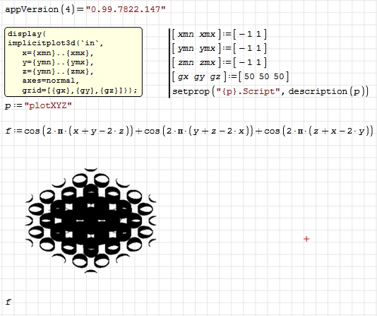

Hi. You can try this:
maple_implicitplot3d.sm (7.32 KiB) downloaded 939 time(s).
Also, can read more about maple complement here.
